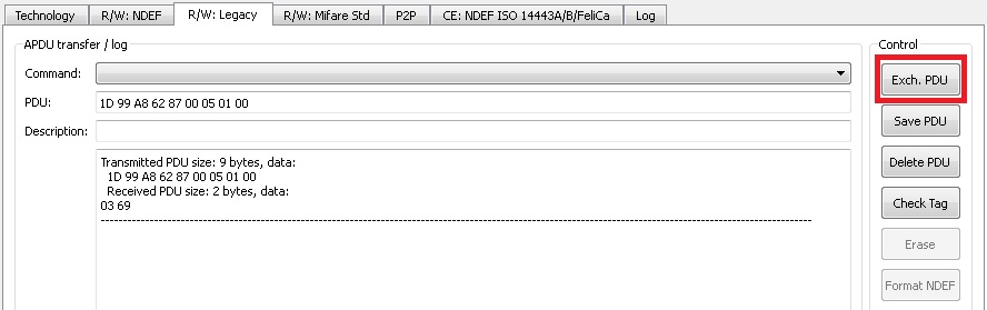

I'm using  MSP-EXP430F5529LP + DLP-7970ABP + Stollman NFCPlayer ( version 1.0.153.5 ) combination to communicate with a 14443 B  tag.
After START R/W  and retrieve of the Detected Device ID (PUPI)  I want to send the ATTB command to the tag but I can't locate any information regarding the structure of the PDU command for the Stollman NFCPlayer software.
Can anyone tell me what is the PDU command structure to be entered into the PDU field of the NFCPlayer so I can communicate further with the 14443-B tag
  • Hi Arian,
    All you need to do is provide the raw bytes of the PDU(s) you want to exchange with the ISO14443B tag by typing them within the PDU box. You then send the command using the "Exch. PDU" button. You can also add a Description and then hit Save PDU in order to save certain PDU's for easy re-use via the "Command" drop down menu.
    For example:
    The above image shows the transmission of an ISO14443B ATTRIB command, and the reply from the ISO14443B tag.

    Encouraging is the fact that I need to enter raw data into the PDU field.
    Not seeing full REQB response makes it difficult to see the Protocol  1, 2 and 3 of the 14443-B tag.
    I followed  your advice and used raw data to transmit the ATTRIB command but the 14443-b tag seems to not respond same as when TRF7970AEVM was used.
    I'm using a valid 14443 B PayPass Debit card
    Below I copied the script of the ATTRIB command transmit but the response shows protocol error.
                  Transmitted PDU size: 9 bytes, data:
                  1D 53 89 90 00 00 08 01 00
                  Received PDU size: 2 bytes, data:
                   67 00
    I'm going to verify it but  I think the  < 67 00 >  represent protocol error

  • "67 00" represent wrong length
  • Hi Arian,
    If you are getting a 67 00, then it would seem the tag has already successfully exchanged an ATTRIB with NFCLink Standalone. The tag I was testing with, I could issue an ATTRIB successfully, but it seems the one you have is expecting Layer 4 commands (following ISO7816-4 protocol) already - which makes sense if it is a PayPass card.
    At this point, the tag is activated in terms of the RFID technology, and now is ready for commands specific to it's payment protocol. Since it won't be NDEF formatted, this is why NFCLink displays the Legacy tab for you. With that tab, you can issue ISO7816-4 commands using the same method as I described for the ATTRIB in order to further communicate with the paypass card.
