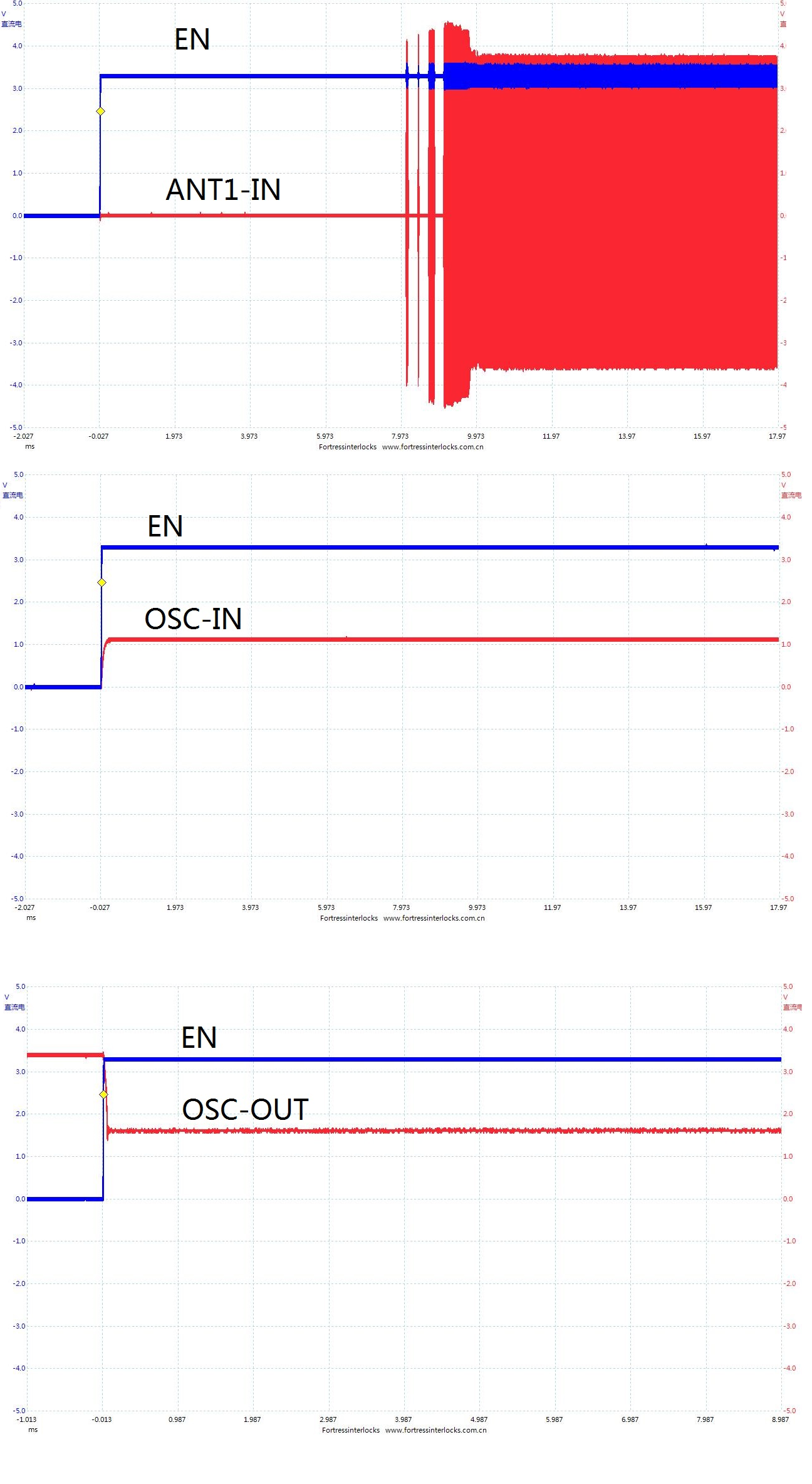

And there is a problem: The signal of the crystal is about 1.1VDC and 1.7VDC, I am not sure it is broken by the ESD. But I can find the 13.56MHz signla on the antenna, as the picture.
Why did it like this? Did the DC signal on the crystal is right?

    1. the MCU is STM32, when I found that there is no data on the MISO, so i check the TRF7960ATB, and found there is something wrong on the OSC pin of TRF7960.
    2. I update 3 pictures as follow, show the EN and OSC and ANT1-IN
    3.I conneted the TRF7960ATB with mcu by VIN(3.3V)/GND, MOSI,MISO, CLK, EN, EN2, SS
    4.I had test the board just with the VCC/GND and the EN, the result is the same.

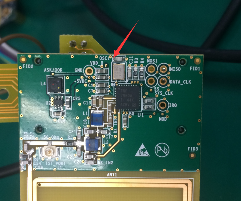

    when I try compile the software, I found there is no data on  MISO, but CLK and MOSI is right, so I trend to check the OSC of TRF7960, and found there is no data on OSC pin.
    my probe was test on the pin of the capacitor, as the arrow show in the picture.

  • thanks for the files. I checked it and sure the pin I probed is right, and now I can find data on the MISO line, but the OSC_IN pin is still no wave, what's wrong? my probe stop the crystal work? but if so, why the IC could work without crystal work?

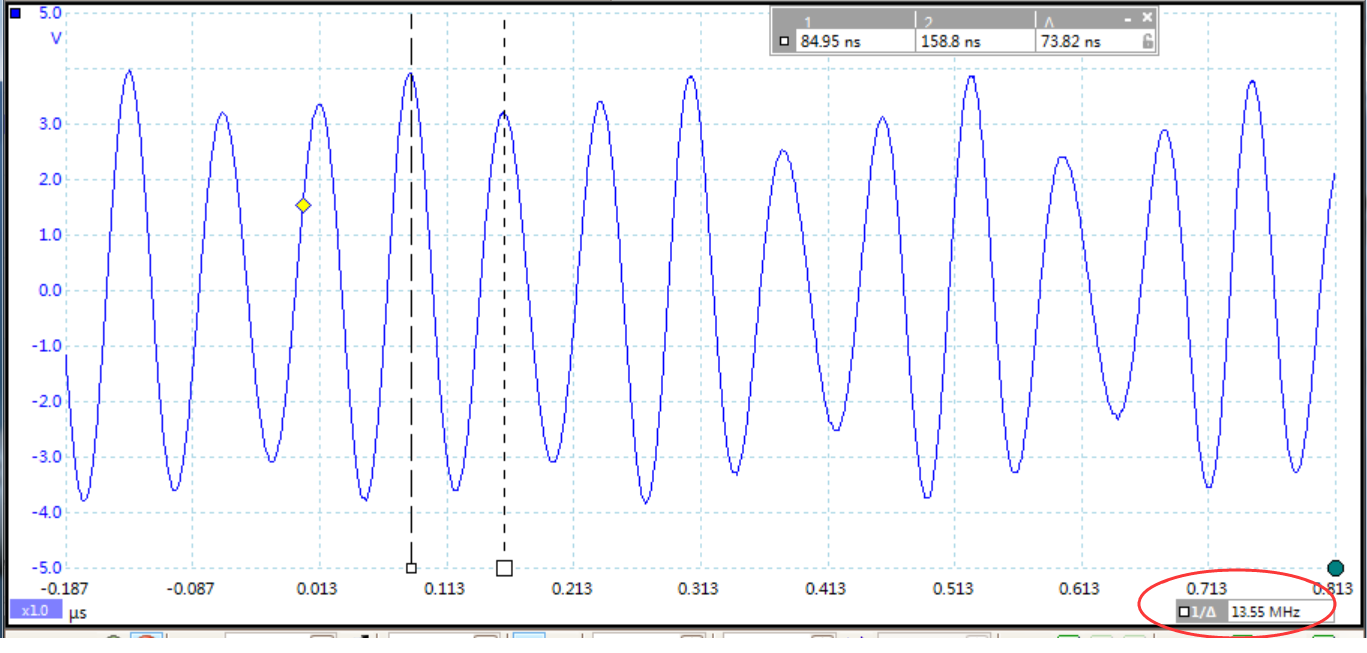

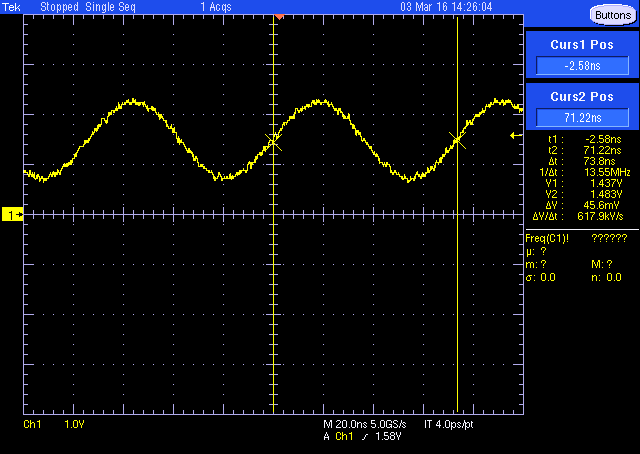

  • maybe your ground is a loop or something - i just went and measured it on -ATB board, using MSP430F5529 EXP board as base.
    here is the capture, measured from same exact spot you are.
    after this i had a thought, can you check that the regulator on your board has a CKT on top marking and not CKR?
    thanks
  • I think my ground is right,because the test result on other point all are right.
    the top marking of the regulator is CKT,.
  • ok, then move on, please - i cannot duplicate or explain it and since your TX is coming on, i think your clock is OK, despite your trouble measuring it. If you have other issue, please let us know.
