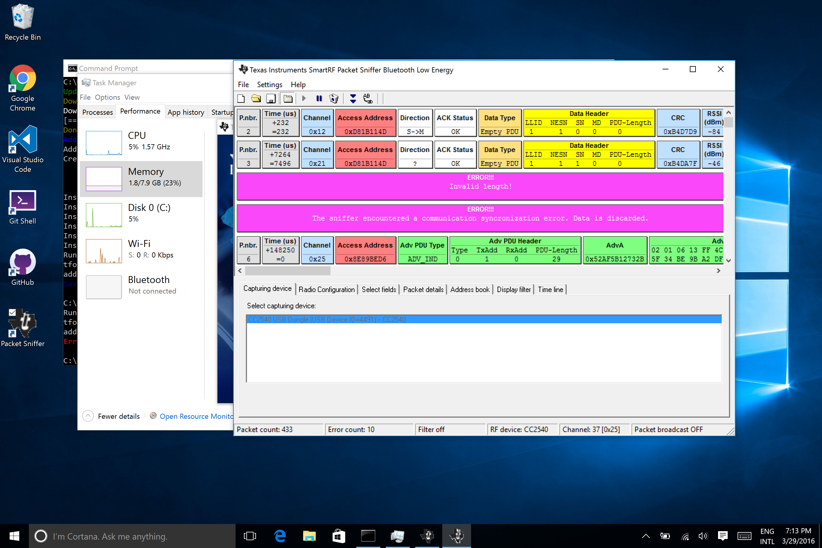

  • Whenever I re-open the app, I see two magenta error messages as shown in the attachment:
    After you re-open the Sniffer app, can you please save the sniffer capture as shown in your photo and send it?
    Also, please check if there is a file under c:\temp. The Packet Sniffer buffers data temporarily to a file there. This file is deleted when the Sniffer is closed, but it might still be there when the Sniffer has crashed. If you have it please send this file also.
    From the logs, it seems that the Sniffer does not receive all packets from the Slave node. One thing you could try is to place the Sniffer closer to both nodes, and also both nodes closer to each other to get a link with less packet errors. Then check if the problem disappear.

  • I've attached the sniffer capture.
    I didn't see anything in c:\temp after the crash.
    I moved the tablet, device and sniffer all right next to each other. The crash was pretty quick the first time. The second time it lasted much longer than normal, but it still crashed as seen in the attached 3240.log.psdlog.
    Just to be clear, the two error packets are always shown in Sniffer after it has been restarted after the crash, right?
    Why does it show advertising packets after the error packets. Has the data exchange stopped in the meantime?
    Have you observed this same issue with longer connection intervals?
    I am not able to see what goes wrong just from these logs unfortunately. I think we would have to try recreate the setup here for further investigation, but I cannot promise when this can happen. I have filed a bug on this.
    Bjørn
  • Yah the error packets show up after opening the app back up after a crash and restarting the sniffing. There's a few minutes in between the error packets and the advertisement packets. The data exchange keeps going after the crash and the transfer completes successfully. Yep, I've seen the same issue with various types of devices at various connection intervals.
