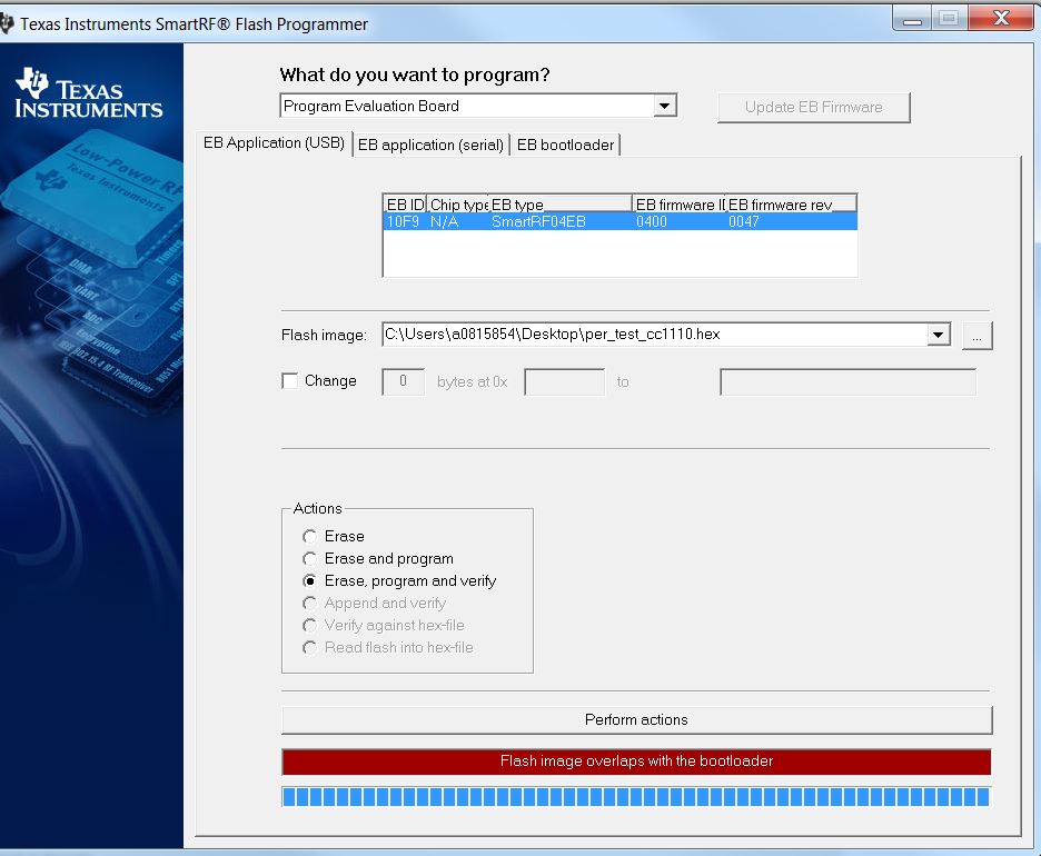

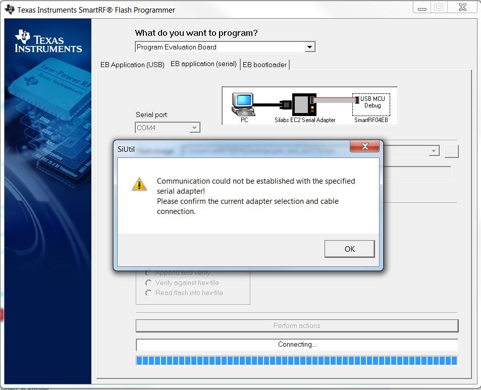

    When i try to program the file "per_test_cc1110.hex" via the USB port, i get the error that the Flash Image overlaps the bootloader. However, when I try to program the serial port, the error becomes one of inability to connect with the board. Baud rate was set at 9600. May I know what am I missing? I attach the error screens.

    The per test hex image will go into the CC1111 device (it is not firmware for the EB board).
    You will therefore have to select 'What do you want to program' -> 'Program ccxxxx or MSP430' (at top of Flash programmer GUI).
    Bjørn
