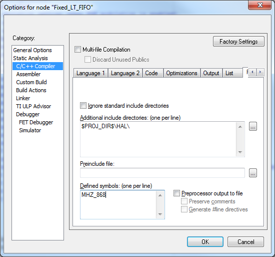

    Thanks for the reply. I was trying with the example code given by TI for packet mode, less than FIFO size toggle code. I'm getting an error stating :
    "../RfRegSettings.c", line 219: fatal error #35: #error directive: "Please select MHZ_868 or MHZ_915 as the active project configuration"
    Can you please explain where should I mention the choice of frequency band.
    Vignesh
  • You need to define which band you are using, MHZ_868 or MHZ_915. In the examples on the web (I am using IAR) this is done as shown below:
