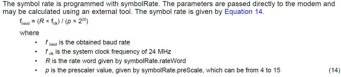

Section 23.7.5.2 of the FRM states " The parameters are passed directly to the modem and may be calculated using an external tool."
What is that external tool and where can I find it?  Is it part of SmartRF Studio?
Also, is the maximum baud rate 6.29x10^-8?  According to the formula given:
With p set to its minimum (4) and R set to its max (2x10^21 - 1 = 2,097,151), the baud rate comes out to 6.29x10^-8.  This seems way too low..  It would make more sense if that equation included the inverse of the right hand side, because that gives a min baud rate of 15,894,579.
