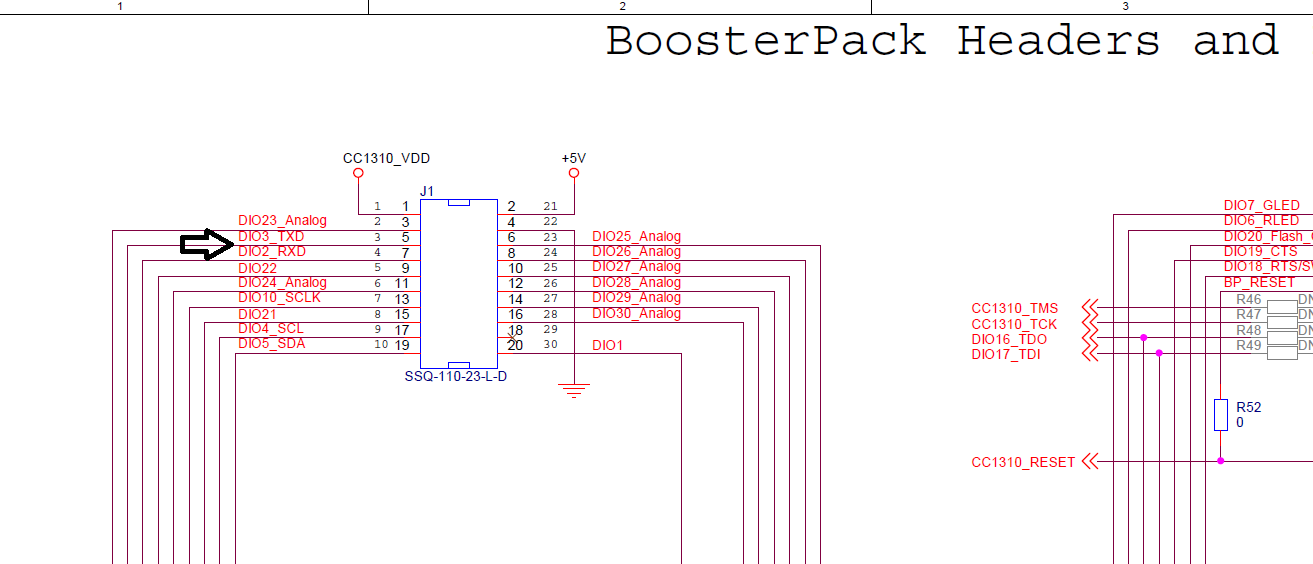

Just noticed when probing around with a multimeter-
J1.3, aka DIO2, is normally the MCU's RXD pin, but it routes to the bottom side of the "TXD>>" jumper in the XDS jumper block.
Likewise J1.4, aka DIO3, routes to the "<<RXD" jumper in the XDS jumper block.  That is backwards as per the boosterpack standard and the RTOS defaults:
#define Board_UART_RX IOID_2 /* RXD */
#define Board_UART_TX IOID_3 /* TXD */
I haven't checked the schematic but the backchannel UART does work, so I assume the physical routing is correct, just the silkscreen labels are backwards.
  • I take this back..... schematic matches the silkscreen for the XDS110 block, and plugging a GPS module's UART output into the upper pin of the TXD>> jumper yields NMEA data on my PC's Putty terminal.
    What IS backwards is J1.3, J1.4 (in the schematic known as J1.5, J1.7) in the BoosterPack header:
    The silkscreen on the LaunchPad shows DIO2 at the 3rd pin, with DIO3 below it, but clearly the schematic has those backwards.
    The silkscreen is correct per the TI BoosterPack standard: http://processors.wiki.ti.com/index.php/BYOB
    The board was just laid out wrong.  This breaks compatibility between the CC1310 LP and other BoosterPacks which expect those UART pins to be in the correct orientation.
    Granted, the XDS110 UART pins are attached to those lines, but one should be able to remove the RXD/TXD jumpers in the XDS110 jumper block and let e.g. a GPS or GSM radio talk to the CC1310's only UART.  Of course in those situations you can still make it work, you just need to remember "DIO2 is DIO3, and DIO3 is DIO2" and update the CC1310_LAUNCHXL.h to compensate.

  • Eric,
    The reversal of the UART pins is intentional, the reason being that we wanted to be able to stack the CC2650/CC1310/CC1350 LaunchPads with an MSP432 LaunchPad and use the CC LaunchPad as a network processor. Unfortunately, a bug was introduced with the silkscreen being wrong, this is being corrected in the latest production batches. The QSG card that comes in the box, the schematics and the data in the BoosterPack checker tool is correct.
    My apologies for any inconvenience caused.
    Karl
