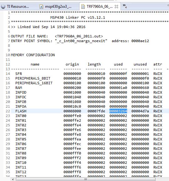

  • i just imported sloc251, built it and looked at the map file.
    looks like its only using 12.9kB of flash, so it should compile in the free version
    it built no problem with v6.1.3.00033
