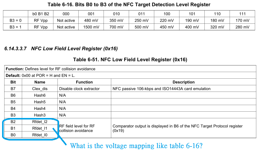

1. How does trf7970a detect collison? Is it detected from RF Rx voltage level?
I see the level setting of RF collision avoidance in register 0x16, but no mapping table of "voltage level to B0/B1/B2 setting" like below mapping for register 0x18 Rfdet_h. Please provide the collision mapping for register 0x16 Rfdet_l  and I can set a higher level for non-sensitive collision detect.

    For question 1, I check the session two in the document, and find below description about RFCA judgement:
    I confused to what the voltage threshold setting is for RFCA detection, RSSI in 0x0F or Rfdet_l in 0x16? It should be 0x16 B0/B1/B2 based on Table 6-51 in slos743k. If you got the clear answer, please feedback to me.

    Rather than use the RFCA direct commands and Register 0x16, we have found it to be much quicker and more reliable to use the RSSI register. The RF Collision Direct Commands (0x04-0x06) have been troublesome to get working reliably, are more complicated to work with, and there is zero benefit to using them over the RSSI method. The only goal of Collision Avoidance is to detect an RF field, and rather than deal with the transmit and receive of the RF collision avoidance packets, using RSSI allows you to just check the RX1 and RX2 lines for voltage signals which would indicate the presence of an RF field. Also for clarity when it comes to using the RSSI feature - when the goal is to check for an external RF field, all you need to care about is the Active channel which is RX1 and signified by the lowest 3 bits of the Register 0x0F result.
    Please see Section 6.5.1 of the TRF7970A datasheet for further detail about how the RSSI register works. This is also where you can find the voltage levels that each result maps to which is presented in the form of two graphs that map out the input voltage level vs RSSI register result.
