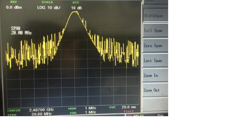

One of my customer want to develop with CC2650 plus PA  for proprietary protocol.
They already test the RF performance with CC2650 Launchpad. One of the parameter they now have concern is  spurious emission.
Picture about is the test result with 2650 LP.
Mode is MAXHOLD, freq is 2.467G, bandwidth is 1M, TX power is 0dbm.   We could get the information that  spurious emission is quite high.
Customer will add in PA to make output power over 17dbm, signal of 2650 should be amplified over 20bB, as well  spurious emission should be amplified over 20dB. So they consider that if it could pass the certification which require  spurious emission < -30dbm.
As we do not have any EVM with C2650 + PA now, could you help test if you have on hand? Thanks!
Vivian

  • Vivian,
    The spurs on that image are caused by the PA ramp being two fast, this is the default configuration. You will need to add a patch that enables controlled PA ramping feature of the CC2650.
    /TA

  • Hello Vivian,
    I cannot see the image from your post. However, the answer is yes, this design requires RF shield to pass FCC requirement.
    Testing for harmonics and spurs was done using CW signal (which is the worst case condition under most circumstances) and we are able to meet the emission requirements for FCC with this test condition. The spurs that are seen on the spectrum analyzer capture from your first post are due to ramping of PA when transmitting packets. If the customer and/or FCC test house insist on testing with packets, the patch that TA mentioned needs to be used to increase PA ramp time. This is the RFE patch "rf_patch_rfe_gfsk" in the latest release of TI RTOS should be applied.
    Also, the latest release of TI RTOS also has an example for proprietary mode implementation on CC26xx which includes this patch. This can be used a as a reference.

  • Hello Vivian,
    The numbers on the table from your post are from conducted measurements. There is no need for RF shield for conducted measurements. However, shield is required to pass radiated tests.
    Yes, that is the correct patch ( At this location by default, C:\ti\tirtos_cc13xx_cc26xx_2_21_00_06\products\cc26xxware_2_24_03_17272\rf_patches). The example can be found under TI RTOS Examples -> Board type (CC2650DK_7ID) ->RF Examples -> RF packet error rate test on IAR and corresponding path on CCS as well.
