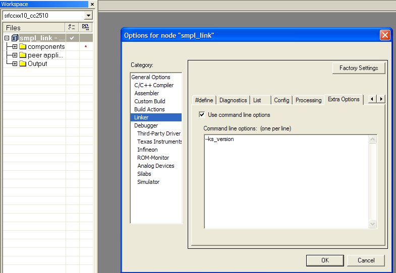

    See page 21/26 in the following document. http://focus.ti.com/lit/ug/swru236a/swru236a.pdf for the following information: "The CC1110 Mini Development Kit 868-915 MHz and CC2510 Mini Development Kit benefit from an extended code size limit in the IAR Embedded Workbench for 8051 version 7.51A and above. A 16kb “SimpliciTI-mode” will be activated by passing the command line option ‘--ks_version’ to the linker (project->options->linker->extra options)."   This will solve the size limitation.

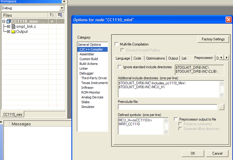

     Also review the Defined Symbols as shown below.
