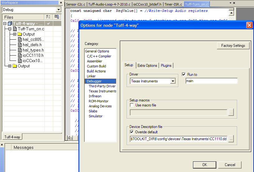

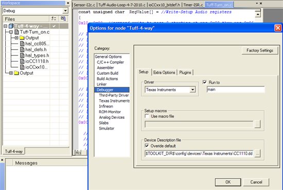

  • It sounds like the set up files changed. The following screen shot is for a CC1110. Make sure you select the device you are using. Hit alt F7 or right click on the project name in the files box.  Also be sure to specify your devices in General Options / Target tab while you are in options. I really like IAR now that I'm use to it.
