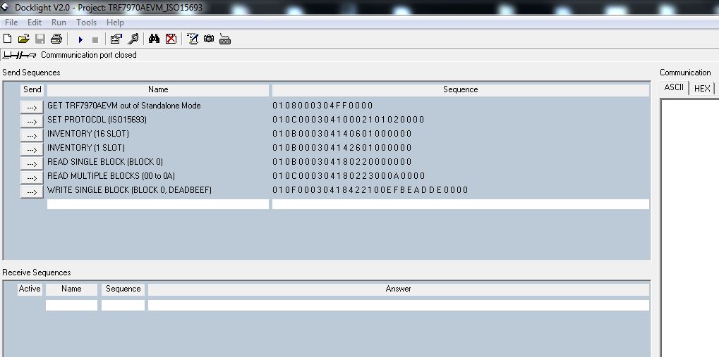

    The configurations are all correct. And I mean if I send "010B000304180220090000" using 'SEND RAW' button in the test tab, I can get some data. But if I use the same configurations in Serial Port Utility, and send "010B000304180220090000", I can get nothing.

  • most likely its ASCII versus HEX you are running into if sending via another program
    or you need to set up the device with other commands like set protocol, etc. first.
    for example:
    in ASCII:
    versus same thing in HEX
  • Thanks Josh,
    I am using the program Docklight and did as what you said, and now it is working well. It solved my problem.
