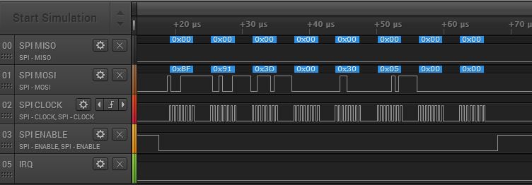

    Sending out REQB with FIFO reset at the start of the command sequence (the last three bytes are what goes out over the air)

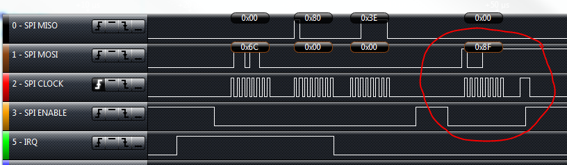

    EOTX IRQ handling with FIFO Reset (circled in red)
  • Hi Josh,
    thank you very much for the answer. My SPI transfer look the same as the first picture, and when measuring on the NFC antenna with an oscilloscope, I can see that something is being sent, so apparently something goes out in the air. But RF430CL330H doesn't seem to respond.
    I will investigate further, but in the meantime, I have a question regarding the SPI I/F:
    According to the TRF7960A datasheet, section Switching Characteristics, DATA_CLK time / 2 is defined as max 250 ns. This equals Fclk = 2 MHz. I have been using a SPI bus at ~500 kHz. Could this be the source of my problems?

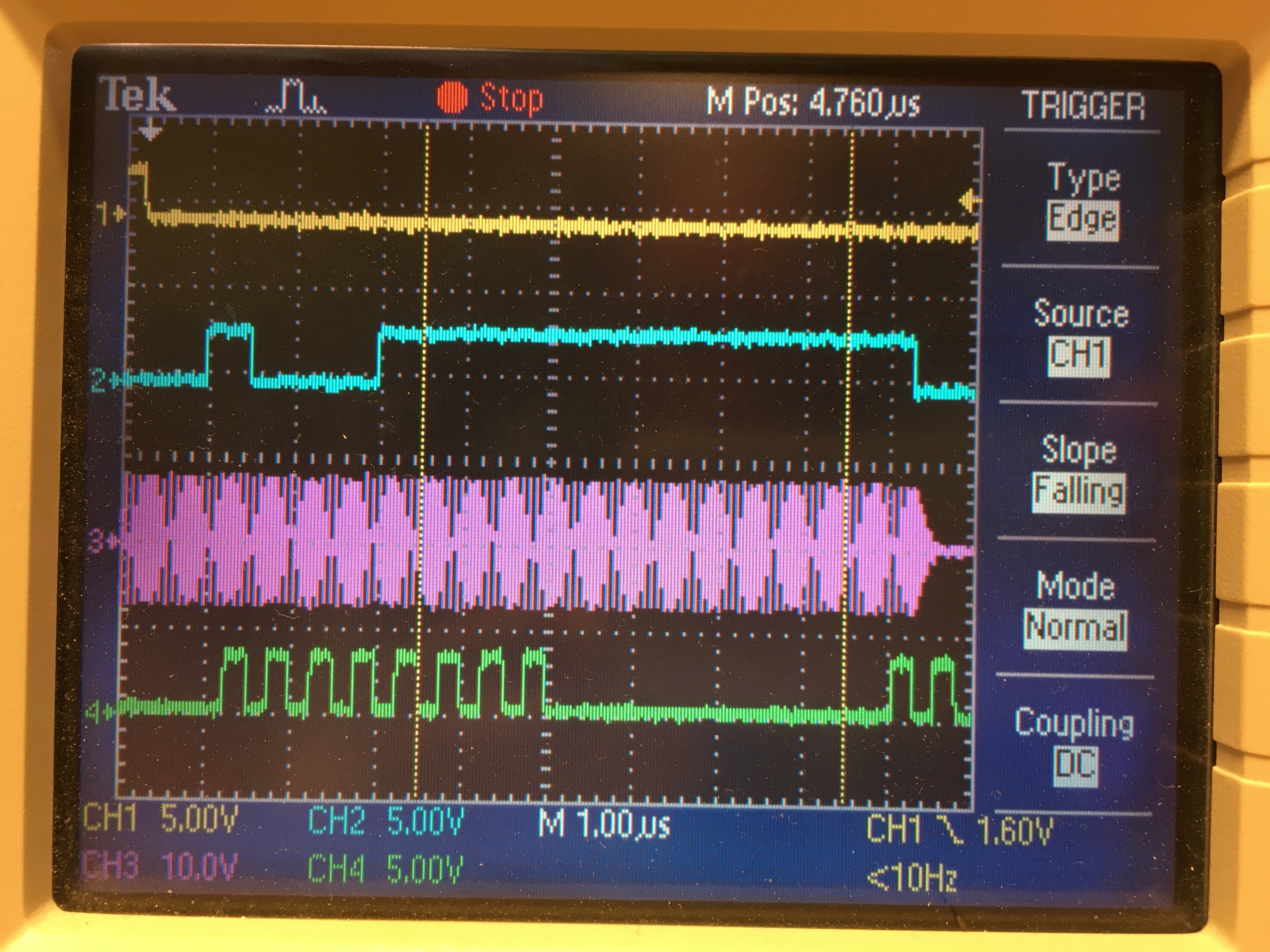

  • Hello again,
    please take a look at this picture.
    1 = SS
    2 = MOSI
    3 = The RF output measured on the antenna on TRF7960ATB
    4 = SCK
    This is what I get when I am starting to send the sequence you suggested above (8F, 91, 3D etc)
    Prior to the situation, the board is initiated according to earlier posts.
    The 13.56 MHz carrier is there at the beginning of the sequence, but then dies and never comes back.
    At the same time, the board current consumption drops from ~100 mA to 30 mA (the latter is probably the consumption of the MCU and a LED display).
    I have measured the 5V on the TB at this point, and it is stable 5 V.
  • Never mind my last question, I found the cause.
    When reading the registers to verify my settings, I sent the register address and then a dummy byte of 0x00 to generate CLK. This worked fine if reading registers with LSB = 0. But if reading a register with LSB = 1, the transition on MOSI from 1 -> 0 during clock phase switch altered something in TRF7960A.
    (I know this is in the errata, but I missed it when updating my device driver to 2 MHz)
    Kind of hard to find though, as it only showed up in the next step, when sending the sequence 8F 91 3D 00 30 05 00 00.
    But I am still interested in the SPI bus characteristics, is there a lower limit of 2 MHz ? Also, how criticial is the duty cycle of the clock? According to the DS, it should be 50% high and 50% low. What happens if there is a deviation from this?
    BR,
    Andreas
