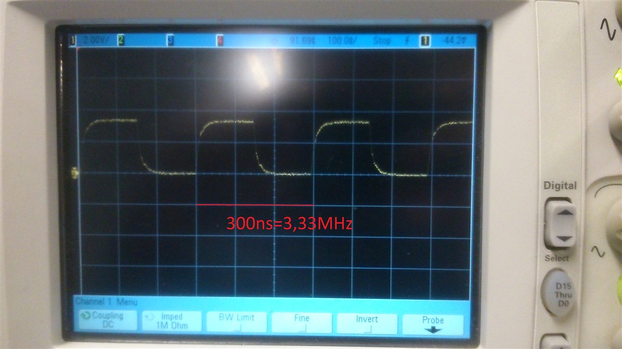

    I have another question. I am trying to communicate the MCU with the TRF7960A via SPI. For this, I have configured the SPI communication like this on the MCU:
    hspi1.Instance = SPI1;
    hspi1.Init.Mode = SPI_MODE_MASTER;
    hspi1.Init.Direction = SPI_DIRECTION_2LINES;
    hspi1.Init.DataSize = SPI_DATASIZE_8BIT;
    hspi1.Init.CLKPolarity = SPI_POLARITY_LOW; //CPOL=0
    hspi1.Init.CLKPhase = SPI_PHASE_1EDGE; // CPHA=0
    hspi1.Init.NSS = SPI_NSS_SOFT;
    hspi1.Init.BaudRatePrescaler = SPI_BAUDRATEPRESCALER_2;
    hspi1.Init.FirstBit = SPI_FIRSTBIT_MSB;
    hspi1.Init.TIMode = SPI_TIMODE_DISABLE;
    hspi1.Init.CRCCalculation = SPI_CRCCALCULATION_DISABLE;
    hspi1.Init.CRCPolynomial = 10;

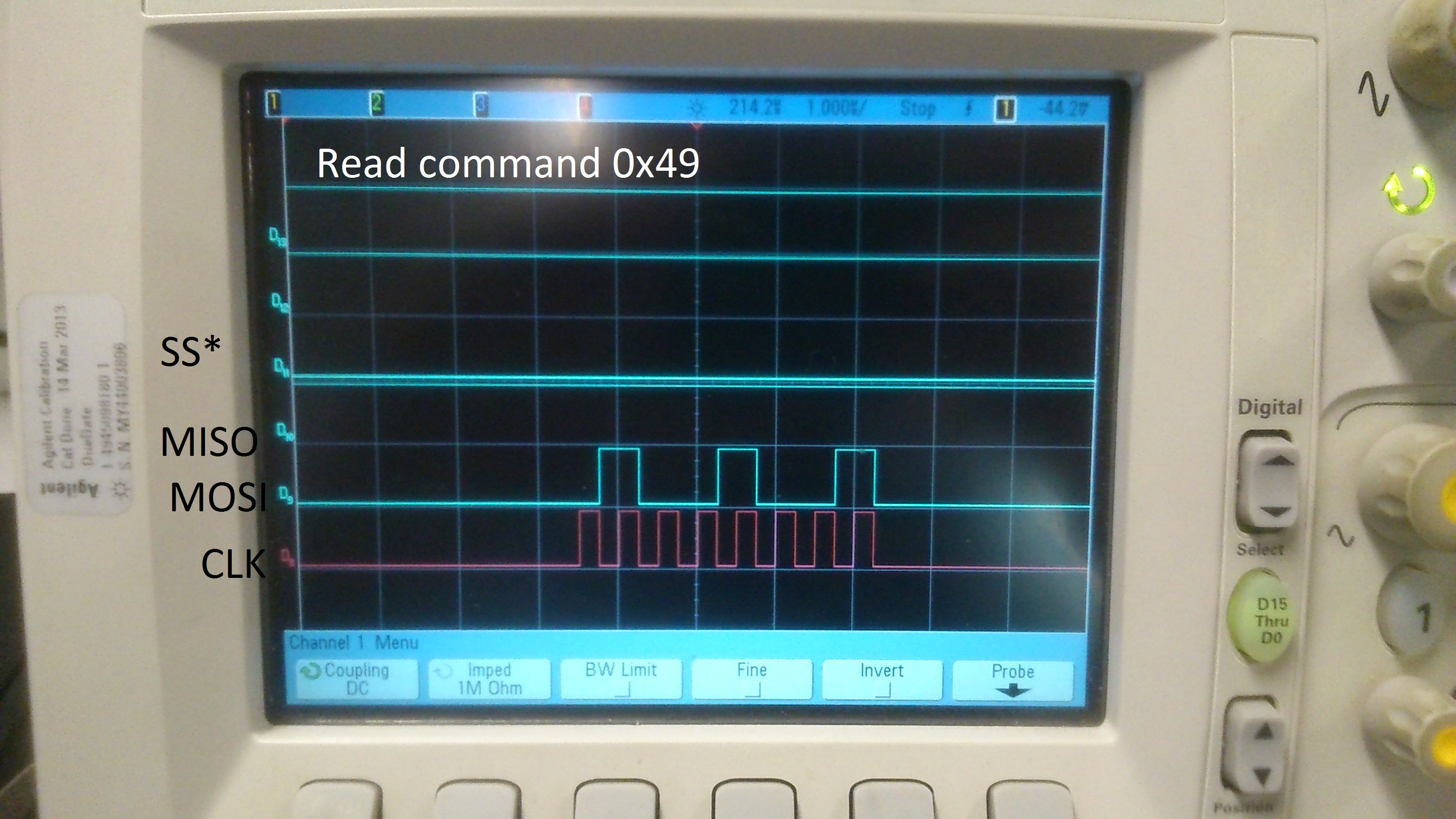

    So the SPI comunication works in MODE=0, and the clock speed is 2MHz. The following image show the data trasmited throught MOSI and CLK is trasmiten in the correct format ; as it´s specified on 6.12.4.2 Serial Interface Mode With Slave Select (SS) on TRF7960AMultiprotocol Fully Integrated 13.56-MHz RFID Reader/Writer IC (Rev. E) document:
    "The read command is sent out on the MOSI pin, MSB first, in the first eight clock cycles. MOSI data changes on the falling edge, and is validated in the reader on the rising edge, as shown in Figure 6-17."
    I try sending a REGISTER READ to show Status of a specific Register, then WITING IN REGISTER a specific configuration, and finaly READ THE NEW CONFIGURATION in the specific register:
    step 1: READ 0x00 Register -> SEND 0x40
    step 2: RECEIVE 0x00 STATUS -> RECEIVE 0x10
    step 3: WITE IN 0x00 REGISTER -> SEND 0x00
    step 4: WITE IN 0x00 NEW STATUS CONFI -> SEND 0x20
    step 5: READ 0x00 Register -> SEND 0x40
    step 6: RECEIVE 0x00 STATUS -> RECEIVE 0x10
    In step 6 it should be read 0x20, but it´s read 0x01 (the last configuration). What´s happen? I only do this process. Should I reset the FIFO before or after this process with followinf plot to save the new configuration?

  • Hello Joseba,
    Have you consulted the TRF7960A Firmware Design Hints document: www.ti.com/.../sloa155.pdf
    I think you are missing the SPI Clock Polarity Change needed when changing from Reads to Writes as covered in Section 7.5 of that document.
  • Hello Ralph,
    Thanks for the answer, you have solved my problem.
