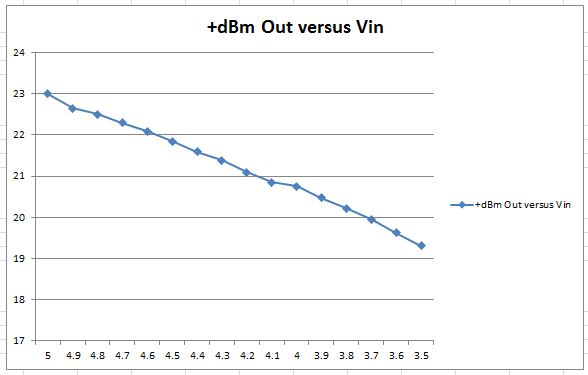

I saw in TI datasheet that power could be 100mW or 200 mW in maximum. I would like to know if there are any curves show the input voltage vs power for TRF7970AEVM. I tried to quntify the power using P=V2/R. I obtained in best case power value around micro watt which is very low comparing to datasheet. Anyone could explain mewhat happen ??

    with +5VDC in, full power out of the transmitter (Chip Status Control Register set for 0x21) is 200mW or +23dBm, half power (with Chip Status Control Register set for 0x31) is 100mW or +20dBm.
    with +3.3VDC in, full power out of the transmitter (Chip Status Control Register set for 0x20) is ~66mW or ~+18dBm, half power (with Chip Status Control Register set for 0x30) is ~30mW or ~+15dBm.
    for your viewing ease, i made this chart based on measurements I made on one unit at room temp, for +5VDC to 3.4VDC input to the TRF79xxA (vertical axis is power out, horizontal axis is Vin), with the Chip Status Control Register Set for 0x21.

    Thank you for your answer. shal I use the PIN Vin and GND to supply with voltage different to 5V. Actually I am using USB cable to supply the TRF7970A EVM reader.
