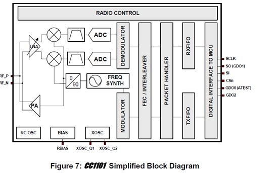

    The radio portion of the chip is a complete transceiver which contains a complete RF modulator/demodulator. The transceiver contains its own RF ADC and DAC's, it also contains all the circuits for successfully receiving an RF signal. The special case of the CC430xxxx family of devices is that the CC1101 transceiver has been integrated in a MSP430 making a RF SOC we are calling CC430xxxx. Below is a simplified block diagram of the CC1101, here you will note the common I/Q based down converter chain, with corresponding ADC and demodulator.
    So using the CC430xxxx series of devices the user has to set the transceiver up by programing a series of registers that control the behavior of the device. I recommend starting with recommended settings for SmartRF Studio 7.x. After the radio has been setup all you have to do is load data into the TX FIFO and retrieving data from the RX FIFO.
    Furthermore the ADC12A that you refer to is completely separate from the RF section and is intended to be used by the user to perform actual measurements on whatever you desire the system to measure. Then you can write code that transfers the results from the ADC12 into the TX FIFO for transmission to you end destination.

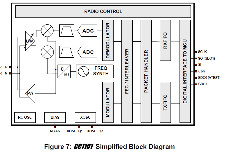

    I've been staring at the CC1101 block diagram for a few days now. Is there a way to access any of the signals passed through the I/Q down converter chain during runtime in firmware?

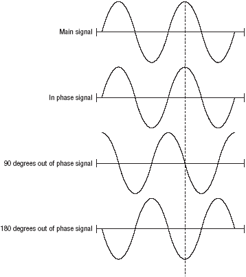

    That's all fine and good, but in addition to the frequency difference there may be an associated phase difference. For example:
    I'm sure the demodulator accounts for the phase difference as well. It would be nice if the value was stored in a register like the frequency difference.
    The reason we need the phase difference value is because it provides a semi-unique key between pairs of communicating devices. The phase difference is affected by the distance between devices and other conditions.

    From the above statement, the local oscillator (VCO) is never the same frequency as the incoming signal, if it were, that would be a zero IF receiver and then there would be a potential phase relationship (still probably not as there are always going to be some variance in frequency unless you synced the PLL to the incoming signal but then since it would be tracking that, you would not get any useful information out of it.
    In general phase offset is something that doesn't matter, in a zero IF situation it becomes a DC signal, in a low IF situation, since the two waveforms are asynchronous, it doesn't matter.
  • Based on what I've read, the IF signal is created by mixing the incoming RF signal with the VCO signal. The PLL is synced to an external oscillator (XOSC) reference signal and generates the VCO output.
    Chris, what you're saying is that syncing the PLL to the incoming RF signal (instead of the XOSC signal) wouldn't do any good because then the PLL output would be in-phase with the RF signal; we can't use signals that are in-phase to determine phase offset.
    Also, since FIF = FRF – FVCO, if the VCO signal was the same as the RF signal then the IF signal would be a zero DC signal and contain no useful information.
    Additionally, comparing the phase of two waveforms that don't share the same frequency doesn't make much sense.
    It seems that one option is to capture the RF signal before it is converted into the IF and compare it to an external reference signal with the expected communication frequency. Of course that assumes nearly zero variance in frequency between the expected and received RF signals.
    After the received RF signal is down-converted in quadrature (I and Q) to the IF all useful phase offset information is lost, right? In other words, those signals are in-phase with the XOSC reference signal.

    I am thinking about this...but pretty much I believe the answers are yes to all of the above. Things like RADAR work well as the source of the RF is also used to measure against, so that makes it pretty straight forward, but with a second source, especially one that is not super accurate, it is harder to tell what is drift and what is phase shift.
