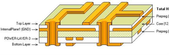

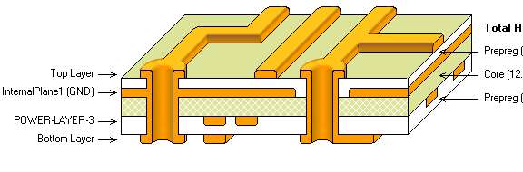

    FR4 is made from sheets of Prepreg, which is itself constructed from fiber glass matting which has been impregnated with the epoxy resin. A standard 1.6mm circuit board is made up of around 8 layers of Prepreg and the outer copper layers. As the weave of the fabric, the mixture of the epoxy, and the pressure they use to press it all into a nice flat board changes so does the dielectric constant. This is just one board. In a 4 layer "board" there are 3 boards pressed together and another opportunity to impact the dielectric constant a bit due to the heat and pressure. With these variables a Er of 4.1 to 4.7 is not bad and is true.  Another variable is the frequency they measure Er at (typically 1 MHz but not always) and how the specific material varies with frequency. See http://www.polarinstruments.com/support/cits/AP125.html for a short but interesting artical.
    A good PCB house will take samples of the material they get and process, and then measure the dielectric constant over a wide frequency range. Using this information they will adjust the width of lines that are specifically called out to meet a certain impedance in your design. All for a price. If you get to know a shop well they will sometimes share the data so you can design to it.
    Another variable often overlooked is the board stack up to get the 4 layers.  This can be (1) a thick core with a thin board (called prepreg) attached to the top and back, (2) two thick boards with a thin board in the middle, or (3) a thick board with 2 thin boards stacked on top.
    The figure is taken from the Altium Stack Manager and shows case 1. This is likely the most common stack up and for low cost and quick turns we tend to use what they have. The overall board might be 1.6mm but with a thick core the top and bottom board could be very thin. (In fact from some off-shore very low cost suppliers the top and bottom can be a non-conductive spray-on with no tolerance at all and should not be referred to as FR4, but is) For line impedance all we care about is Top to Layer 2 (GND) thickness. Case 3 above might be the best; use the thick core for Top and Layer 2 where the lines are wider and less sensitive to width variations, the material tougher so changes less with processing, etc. Then use two thin board for layer 3 and 4. I most cases this would be a special order and expensive.
    The take away is understand your PCB house's stack up for your boards and correctly set up the stacks in the CAD program.
