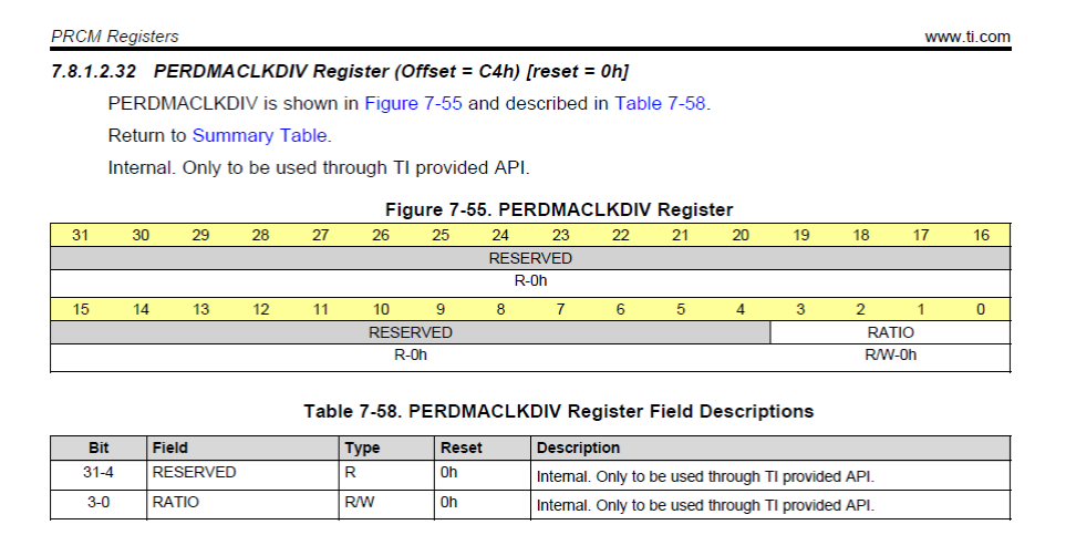

As the description in TRM, PERDMACLK can be configured by TI API. Customer has question that whether it can be set to use 32.768K crystal?
