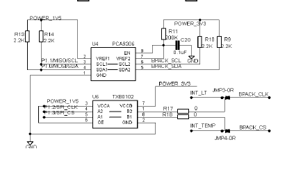

  • Hello Anil,
    Having two pull-up resistors does not make sense to me, and also the value on host end is very high. Can you reduce it to a single pull-up? 2.2kOhm may be okay, or you could use something like 4.7kOhm.

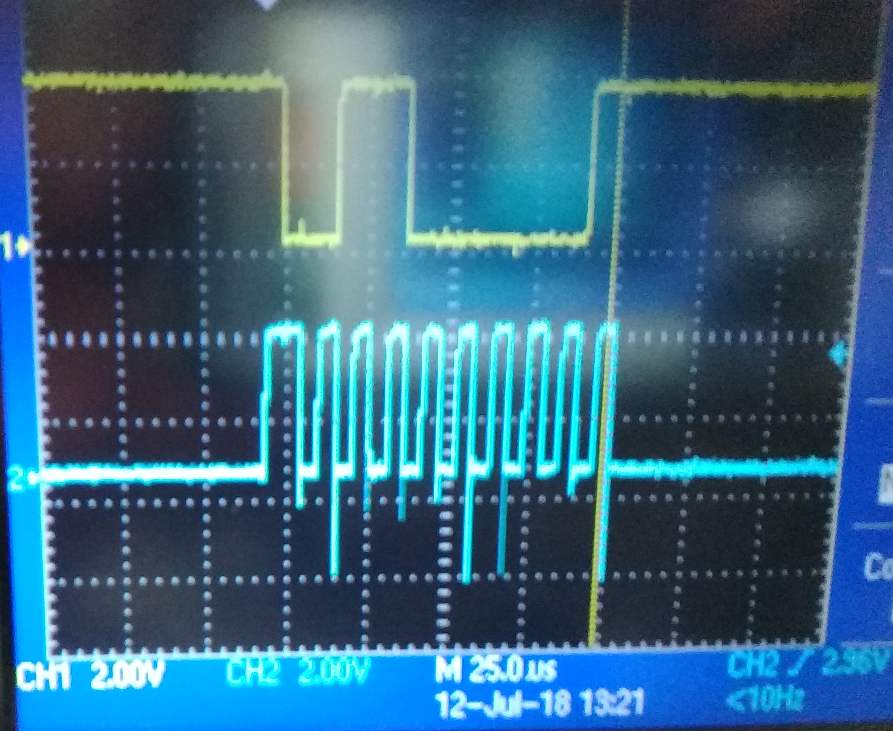

    When you look at the I2C lines, what do you see signal wise? Do you see the master output? If so, is there any reply from the slave?
    Thanks for your reply.
    During debugging , I have observed that cLock  is generating from Master end properly.
    Start bit is also ok.
    Multiple times , I have observed that interrupt handling of rf430frl152h is little different from other MSP430 devices. Can you just confirm and check the i2c initialization and interrupt handling from attached slave source code. ?
    Thanks in advance for your reply.

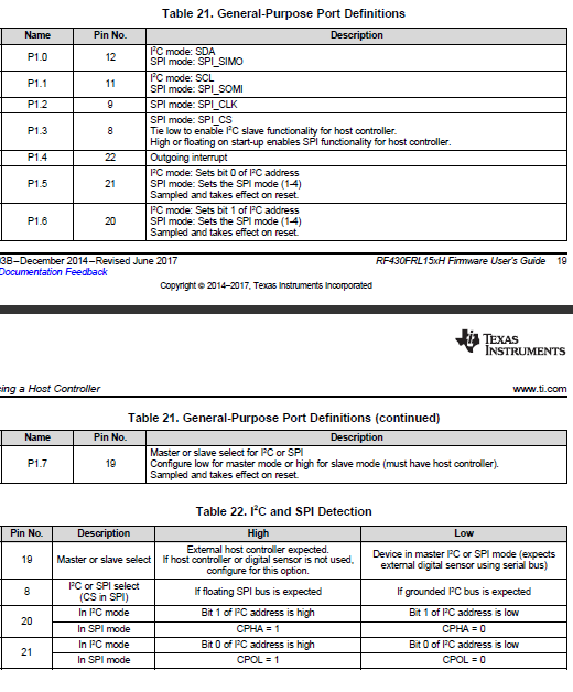

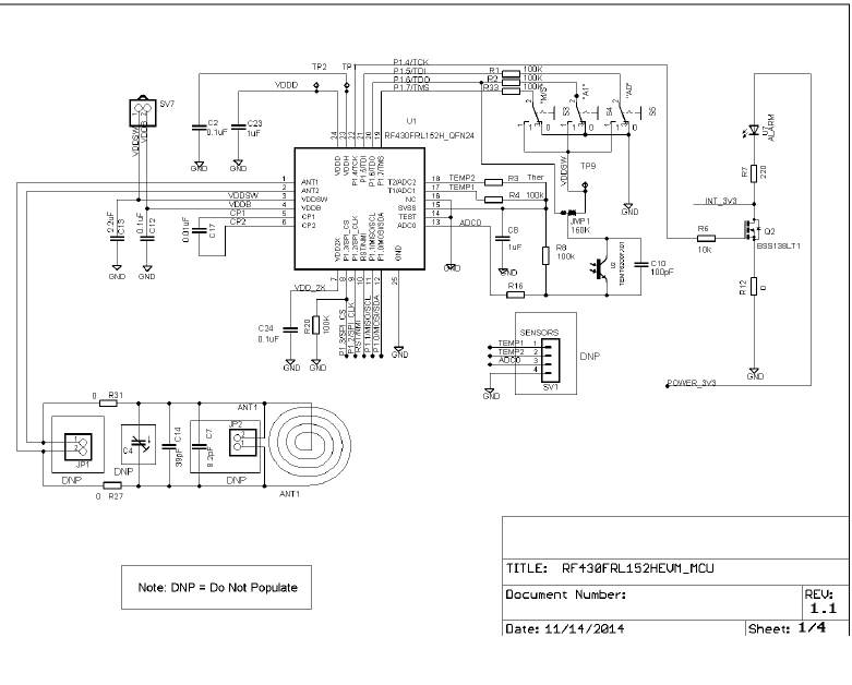

  • Hi
    Please find further observations regarding same reported issue.
    I am using MSP430G2 (EXP430G2) as Host controller and RF430FRL152H as I2C slave device. at Slave side only 2.2k pullup resister is connected on SDA and SCL pins.
    1.  Start bit and device address is showing correct  from master to slave device (varified on CRO)  but ACK is not responding by Slave device. clock (SCL) is also ok.
    2. All pin status is varified as per datasheet and schemetic given below:
    3. It is observed that after receiving adress command UCBBUSY is becoming high. If it is getting high then why ACK is not responding by slave?
