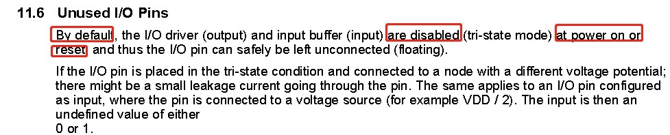

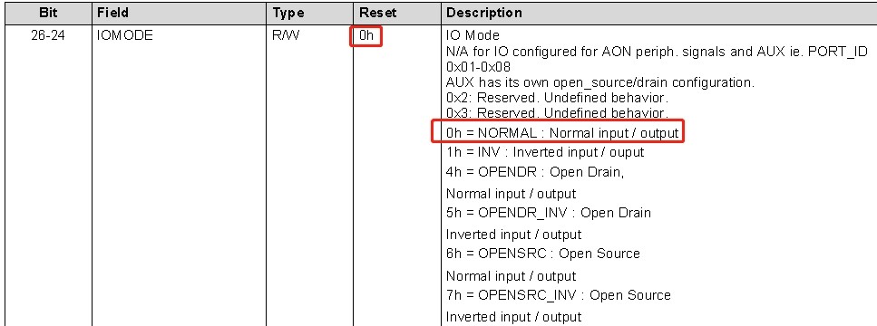

From datasheet we can see the state as below picture(One example) after Reset.
And we want to know whether is the pin tri-state mode?
