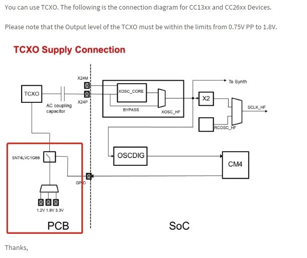

Dears:
From the below picture there are 2 issues:
1. What the function about AC Coupling capacity? Could we delete the design?
2.Why does there have 3 different voltages? Is there some specific description about clock of CC2642R?

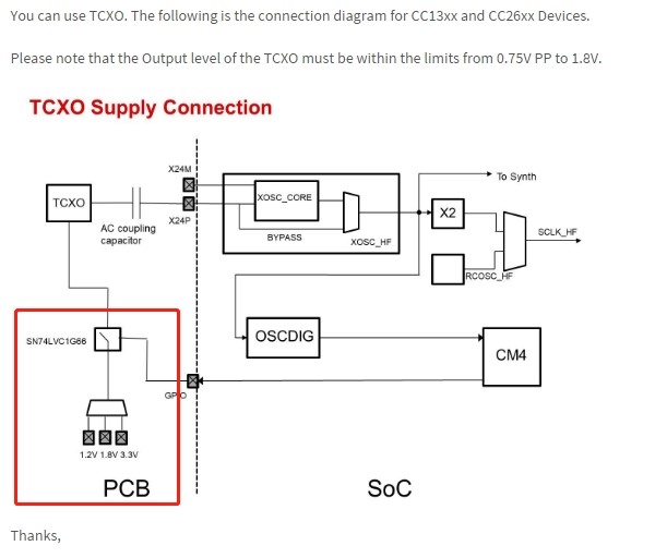

Dears:
