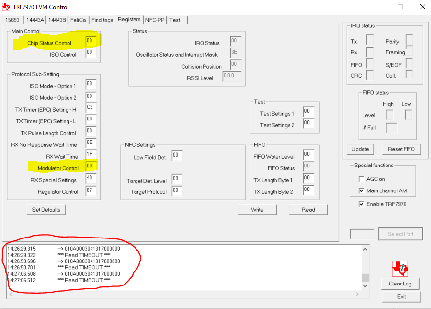

I was trying to configure the reader to send the carrier signal-13.56MHz using the TRF7970 EVM Control GUI by making the following changes:
Chip Status Control is 0x00 and Modulator Control is Register 0x09
But I am unable to Write this into the device no matter what my settings are.
Looking forward to hearing from you.
