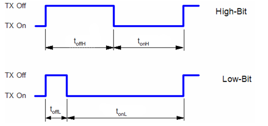

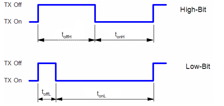

  • which tags are you using? if R/W, MPT or MUSA, then you just need to respect the timings of the write, per the tag device.
    for example:
    Tag Type  toffL (μs) tonL (μs) toffH (μs)  tonH (μs)
    R/W and MPT 300 1700  1000 1000
    MUSA 170 330 480 520
    where the carrier modulation is looking like this:
    and this is the general form for programming the R/W transponders is:
    and this is the general form for programming the MPT transponders is:
    if you can indicate which transponders you are trying to write - then you can follow the form and/or we can help guide you further - thanks!
