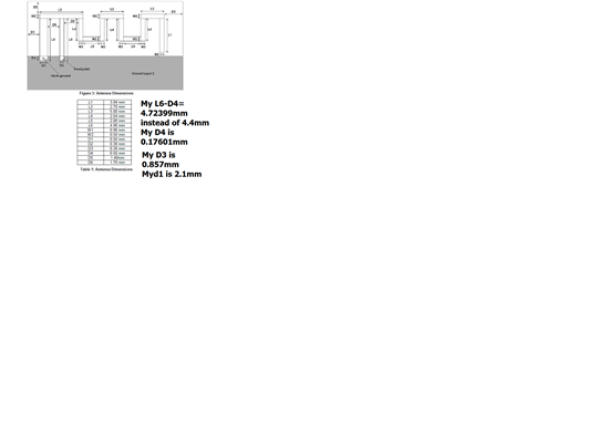

Dear TI,
We at Sumona consulting are developing a ZIGBEE based home automation system .we are in the design stages of developing a usb dongle using CC2531,CC2591 and Inverted F Antenna.
For designing the inverted F antenna we are using TI document DN0007 and for cross reference we are using the CC2530_CC2591_EM gerbers (SWRC171).while going through both the documents we found out that; the DN0007 says that total length (L1) should be 25.58mm.but the CC2530_CC2591_EM gerbers shows 25.98mm total length.
second point is all the dimensions in the CC2530_CC2591_EM gerbers is 0.2mm lesser than the dimensions mentioned in DN0007.please  clarify and suggest us which document to follow.
Please find the attached documents
