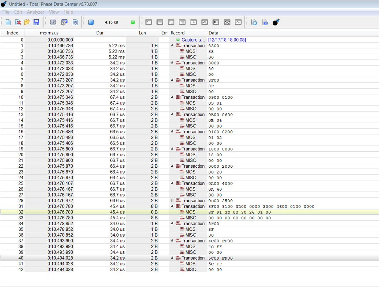

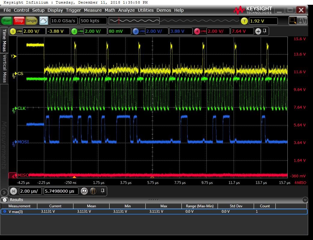

    Have you placed a logic state analyzer or oscilloscope on the SPI lines to observe the traffic and verify bytes are sent/received as expected?
    Yes. I am able to use the analyzer and observed the bytes sent/received on the MOSI and MISO lines. I have modified code and to keep CS line low during continuous write(this is not captured in  above image).
    It will be great if you provide example code to read TRF7970A FIFO data from CC2640R2 Micro usin SPI with chip select.
    Narsimhulu Kuna

  • Hello Kuna,
    Inconsistent TX Complete IRQ's tell me that something is off regarding the timings. To further debug the issue, I would need to get a complete SPI capture with timings between each command to review. This can be done with a Logic State Analyzer such as what is provided by Saleae.
  • Ralph Jacobi,
    I will share SPI capture (Logic State Analyzer) soon with you. Please find the output captured by SPI Analyzer with this reply. One more behavior, we have observed
    SPI Single read is not working after sending Inventory command but it was fine before sending Inventory command.
    Kuna
  • Hello Kuna,
    Few comments:
    1) There seems to be a fairly large delay between sending 0x83 and then 0x80, that is not correct for soft reset, you need to send these commands sequentially and then delay after the 0x80.
    2) Try using Regulator Control setting of 0x00 rather than 0x06 for starters, sometimes depending on VIN to the device, higher regulator control settings can't get supplied the desired voltage and that impacts performance (for example at 0x6, you want VIN = 3.3V and VIN = 3V would cause issues).
    3) It looks like you are writing Register 0x0D with 0x25? If so, do not do that. First off, you would only write it with 0x3F if you are doing anti-collision, but your command is for single slot inventory so you should leave it as the default 0x3E.
    See if those adjustments solve the issue.

  • Hello Kuna,
    Maybe I don't understand how to read your SPI data from that analyzer but the timestamps to me pretty clear indicates there is 5 ms from when 0x83 is sent to when 0x80 is sent:
    # Level Index m:s.ms.us Dur Len Err Record Data
    0 0 0:00.000.000 Capture started [12/18/18 21:18:55]
    0 1 0:03.368.231 5.226.500 ms 1 B Transaction 8300
    1 2 0:03.368.231 5.226.500 ms 1 B    MOSI 83
    1 3 0:03.368.231 5.226.500 ms 1 B    MISO 0
    0 4 0:03.373.529 34.300 us 1 B Transaction 8000
    1 5 0:03.373.529 34.300 us 1 B    MOSI 80
    1 6 0:03.373.529 34.300 us 1 B    MISO 0
    0 7 0:03.374.702 34.300 us 1 B Transaction 8F00
    1 8 0:03.374.702 34.300 us 1 B    MOSI 8F
    1 9 0:03.374.702 34.300 us 1 B    MISO 0
  • Hi Ralph Jacobi,
    Thank you for your reply. We will sort out delay issue.
    will the 5 ms delay between 0x80 and 0x83 impact on Tag reader functionality?. we are able to initialize and configure TRF7970A properly with the delay. We read register configurations using SPI single read function. It looks like everything is fine before sending inventory command. We are not able to read register configurations after sending inventory command and not getting IRQ. Please let us know if you need any additional details.
    Thanks.
  • Hello Kuna,
    Yes it can because the device is not being properly initialized per our DS specs. Reading the registers doesn't mean that tag reading functionality is online, it only means SPI communication is correct.
