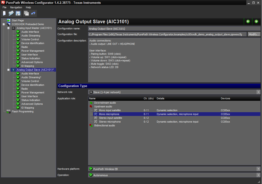

  • Dear sir.
    Thank you for your reply.
    I tried but Can not work two slave microphones.
    Below are my PPW setting.
  • Dear sir.
    I can not change  I2S Channel Left.   As you can see still  Red color X box.
    How can I change this function?
    I think 2 slaves microphones should be setting I2S channel Left.
    Two slaves One master pairing good  but  one slave no sound.
    I want use two slaves microphones   and one master speaker at the same time.
    Thank you.

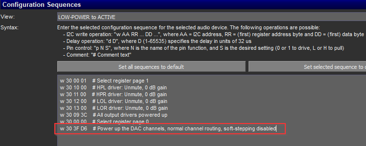

    Both microphones can't be using the same I2S channel Left (CC85xx Master can't mix the two channels together).
    What you can do if you want to mix the two channels together is to do it in the audio codex. You can configure the codec so that it outputs a mix of left- and right input data:
    To do this you need to do a Custom setup on your codec under that Audio Interface tab and then you'll get a new tab called Audio Device Customization
    R.M

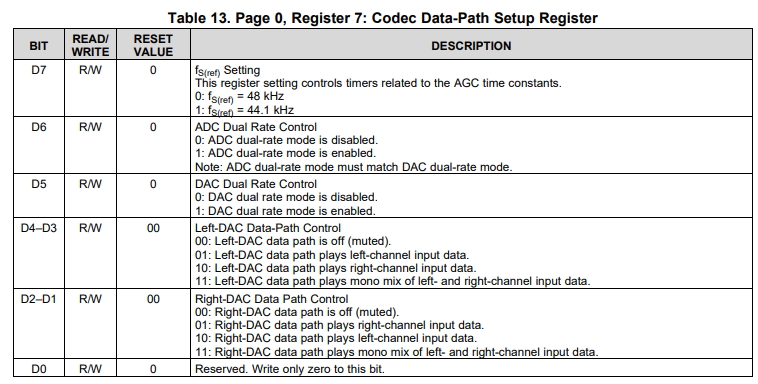

  • Dear R.M
    Thank you for your answer.
    But I can not understand 100% because I don't have full AIC3204 codec data sheet include I2c register setting.
    This is AIC3204 codec "Audio device customization" tab

    I already modify value w 30 0C 08 -> w 30 0C 18 but not change anything.
    (final output is HPL headphone left channel)
    What can I change if I want use two microphones together?
    And Where can I find AIC3204 codec's full datasheet with I2C register value descrpition?
    Thank you for reading.
    KIM
  • Dear Kim,
    Application reference guide for AIC3204 can be found here:
    The register to modify for AIC3204 should, according to the doc linked above, be register 63 on page 0. Try to change to w 30 3F FE below:
    R.M
  • Dear R.M
    Good to see you again ^^
    I tried that It's very good work ^^
    Thank you very much.
    KIM
