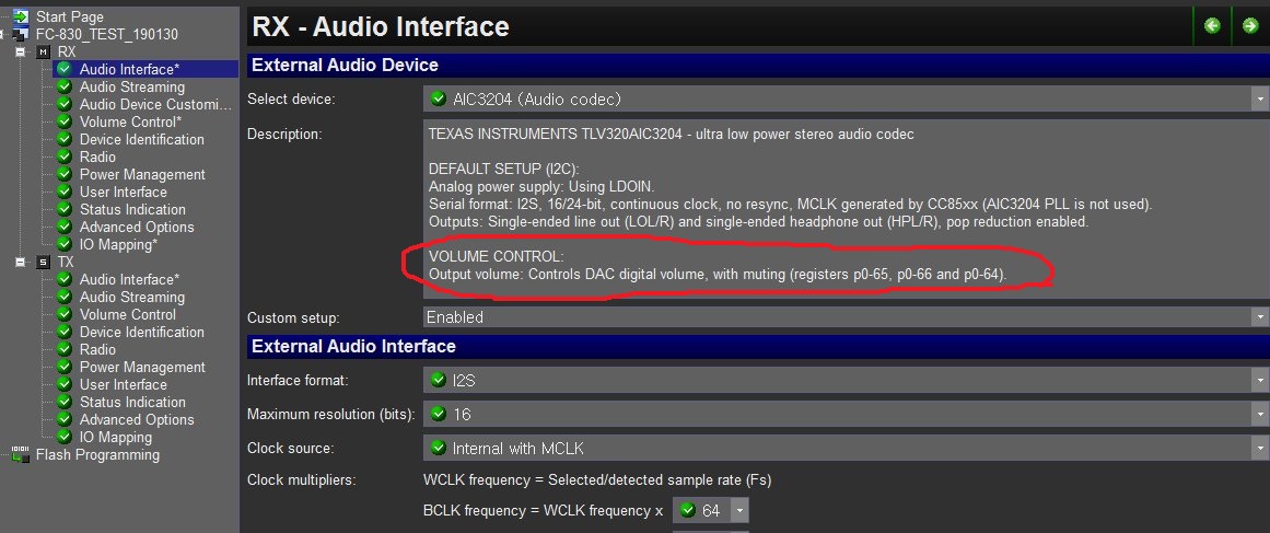

I have a question about AIC3204 CODEC audio signal routing path volume up/down control  with PPWC software.
Please see the attachment file.

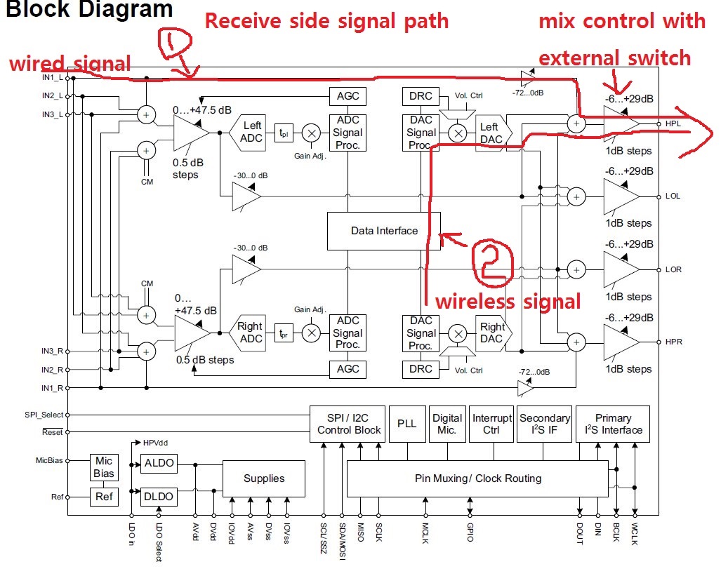

AS you can see  Volume control are DAC digital signal control  But, I want to control all audio signal with external audio input signal using PPWC software.
Please see the  attachment another file.

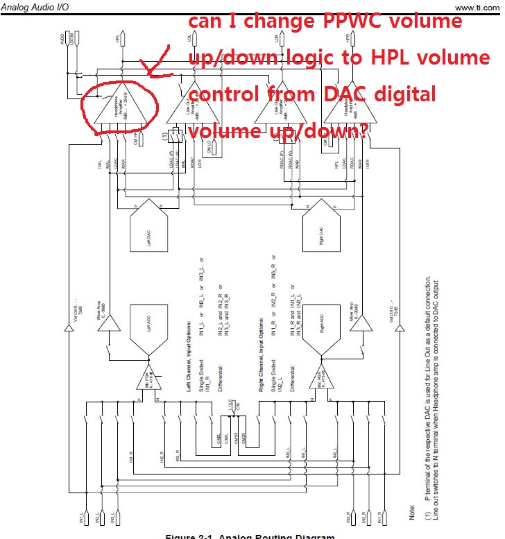

I want to control HPL volume up/Down  using PPWC.
Can I control HPL using PPWC with external switch?
Bacause Master side require external audio signal input via IN1_L port  and then mix from Slave side wireless digital voice signal and then I want to control
Master audio signal and Slave wireless voice signal  with external switch HPL output.
Is it possible??
I want to control mixed signal   HPL volume control with external switch for volume up and down.

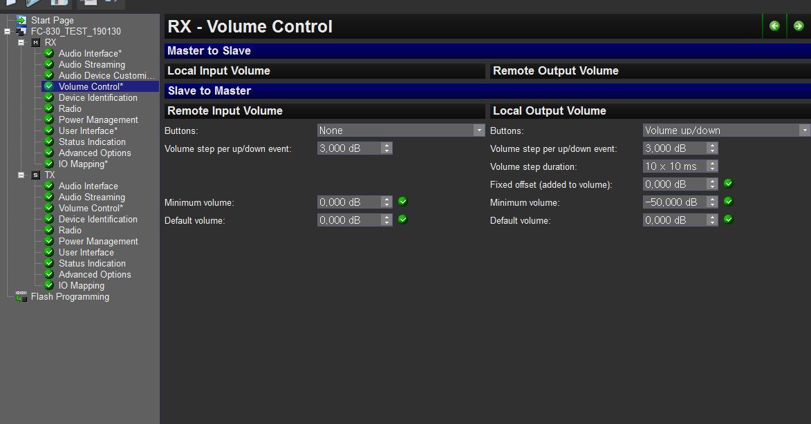

  • Hi Kim,
    Refer to the PPW documentation for available options for remote control. See the CC85xx User´s Guide, as well as the help menu in PPW Configurator.

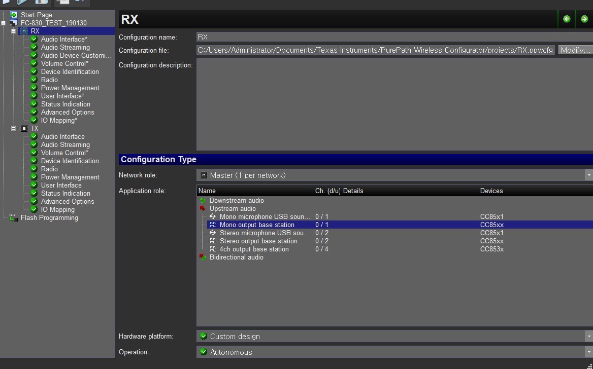

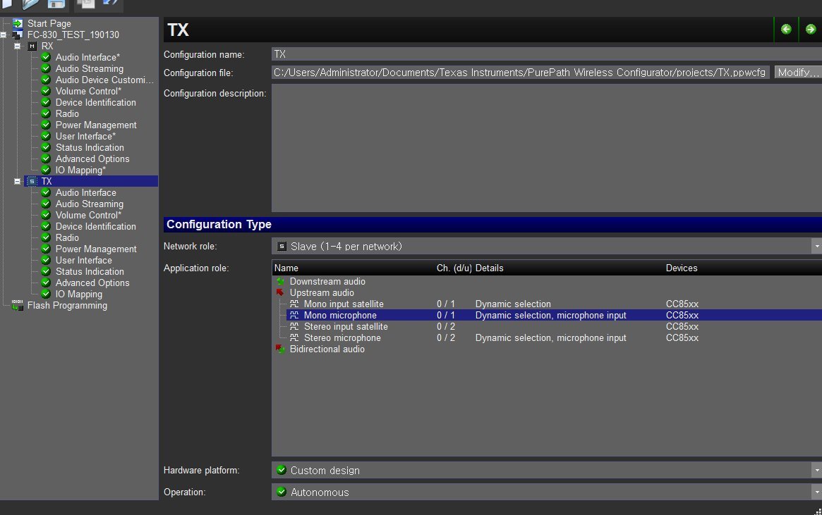

    This is my project PPWC setting image value.
    This is role descriptions.
    TX (slave)  ---->  wilreless microphone  transmitter    voice signal source
                               only   one voice signal
    RX(Master)  ------>    wireless  receiver  with external switch for volume up/down
                                      wireless voice signal from TX  + external AUX signal with wired
    So, I want to control RX(Master) side all mix signal   using external switch volume up/down.
    How can I control all mixed signal at RX  HPL volume control using PPWC????
