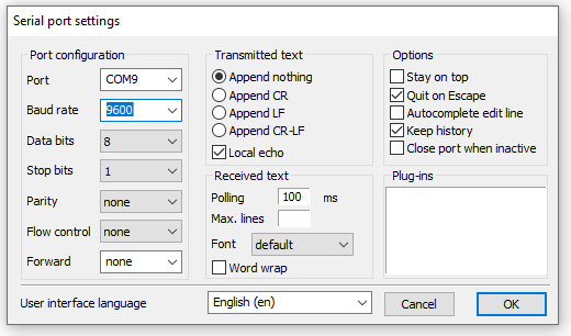

  • Hello Minhyung,
    please see the following screenshots for a sample Termite Terminal session with the TRF7970ABP+EXP430G2 and the RF430FRL152H EVM.
    It is essential that no CRLF is transmitted when sending the commands.
    In the last line of this session you see the data read from block 9 which contains the ADC value
    Helfried
  • I did it.. but it is not working in my PC....
    I post the detailed bellow thread. Please help me...
    e2e.ti.com/.../804846
