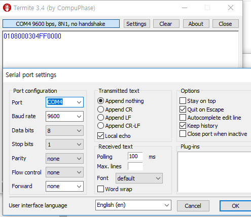

I am using RF430FRL152H and MPS430G2553 + TRF7970ABP to create a customboard.
The RF430FRL152h custom board which operates with NFC is to receive the LED light by the light sensor and send the data to the master kit MPS430G2553 + TRF7970ABP and send it to the PC to display it. We are going to display the data in Matlab.
In order to do this, we get to know that you need to enter TRF7970A command.
Command: 0108000304FF0000 Response: TRF7970A EVM
Command: 010C00030410002101020000 Response: Register write request
Command: 0109000304F0000000 Response: AGC Toggle
Sequence for the Demo Mode:
Setup RF430FRL152H virtual registers (write block 1,2,0)
Command: 01130003041802210100000000000000000000 Response: Request mode [00]
Command: 01130003041802210211111008000000000000 Response: Request mode [00]
Command: 01130003041802210001000701010100400000 Response: Request mode [00]
Read ADC data (read block 9) (Adr. 0xF8B0 - 0xF8B4)
Command: 010B000304180220090000 Response: Request mode [00D027DC266C25FFFF]
So I typed the commnad into Termite.exe, but nothing happened. I tried it on another PC, but the problem was not resolved. What is the reason?..TT

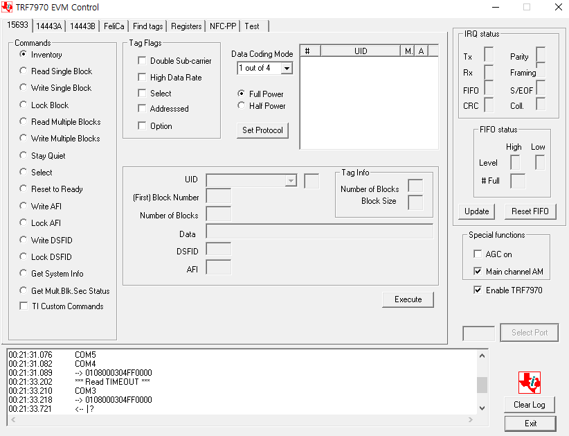

Also, I tried it in TRF7970 EVM Control, but it is not working too.
Is the problem with MPS430G2553 + TRF7970ABP?
I attached screenshot of Termite.exe settings and TRF7970 EVM controll
