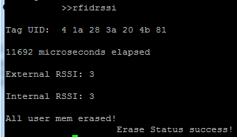

    At every distance interval (moving along the Z-X plane at 1mm increments), I am polling for the tag, reading the tag UID on connection, and writing to every page of user memory in the tag, in order to see at what distances the current antenna I'm working with will have a good enough connection to do a full tag write. Generally, I will either (1) get a successful read of the UID and successful wipe of the tag (writing zeros to every page), or (2) will fail to connect to the tag - ie, my polling command will fail and the tag won't reply. Occasionally, (3) I will successfully read the UID, read the RSSI, but fail in writing every page to the tag's user memory, as with my output shown below:
    Its strange though - at a distance of 5mm in the Z axis, and 12mm in the X axis, I am getting a full connection - case 1 - as shown below, with an RSSI of 3:
    But when I move over a single mm in the X axis - to 13mm, I get the output shown below, indicating the tag cannot be found:
    In between the 12 and 13mm increments, I either connect to the tag with an RSSI of 3, or fail to connect at all. This is my issue - I should not be going straight from an RSSI of 3 to a failed connection - and is why I suspect I am doing something wrong with regards to measuring the RSSI.
