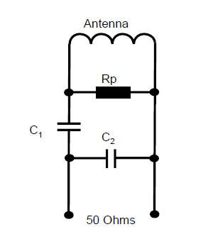

  • Brad,
    For this coil, you should do a capacitive match.  The schematic should look like the image below.
     First, remove all components and measure the complex impedance of the coil alone at 13.56MHz.  This is expressed as R + jX.  You can also measure the inductance of the coil alone.  You can then follow the antenna tuning details shown in the TRF7960TB guide(section 13).  If you need assistance, let me know what complex impedance and inductance you measure and I could give you estimated rough tuning values.
    Also, if your inductance is low, you can make the copper tape trace thinner to increase inductance.

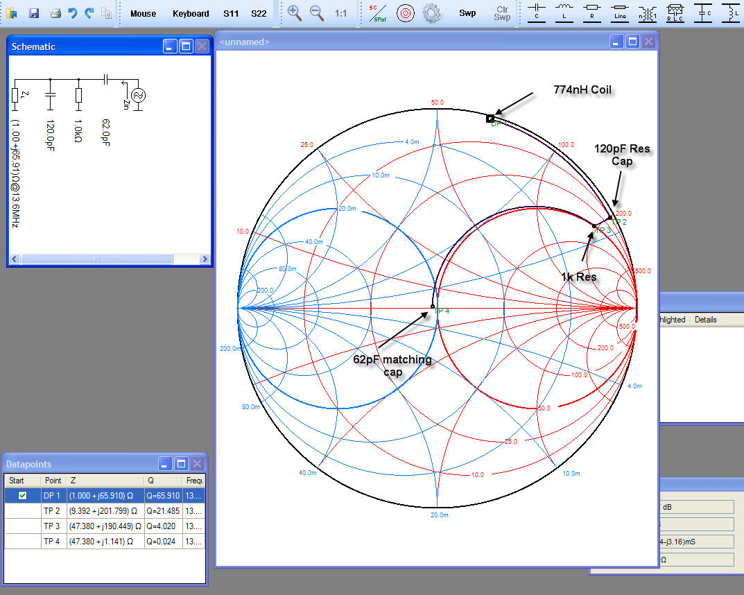

  • I have made a lot of progress and believe I know where to go but and confused on one thing. First I did measure my impedance to be 1+j61.34. Using the formulas specified in the TRF7960TB users guide I calculated Cres=191pF and R=1226ohm == 1.2k. From there I simulated and built the following circuit.
    This circuit was able to get the antenna frequency down to 13.56MHz but but R=1 still (50 needed). I realized your circuit setup in the previous post hinted to building the circuit the following way. The one confusing thing is that you suggest two different circuit layout which greatly change the design. I did simulate the circuit with the parallel capacitor before the series capacitor and came up with the following values. Would this be correct. (I am waiting on different capacitors in order to try this circuit out.) When measuring this layout using (2) 20-180pF caps I can get the impedance to be 4-j0. This seems to be the same response I get when simulating using values of those values with this layout.
  • Brad,
    Sorry for the confusion there.  The series cap should come after the parallel components.
    Unfortunately, I cannot read the values you used in the Smith Chart plot.  If complex impedence is 1 + j61.34, I see the following values:
    R parallel: 1.2k ohm
    C Parallel: 139pF
    C Series: 56pF
    These values should get you very close to free space tuning.  Keep in mind that the TB board had a complex impedence of 0.8 + j80.8.
    Give these values a try and let me know how it works out.
    Eddie LaCost

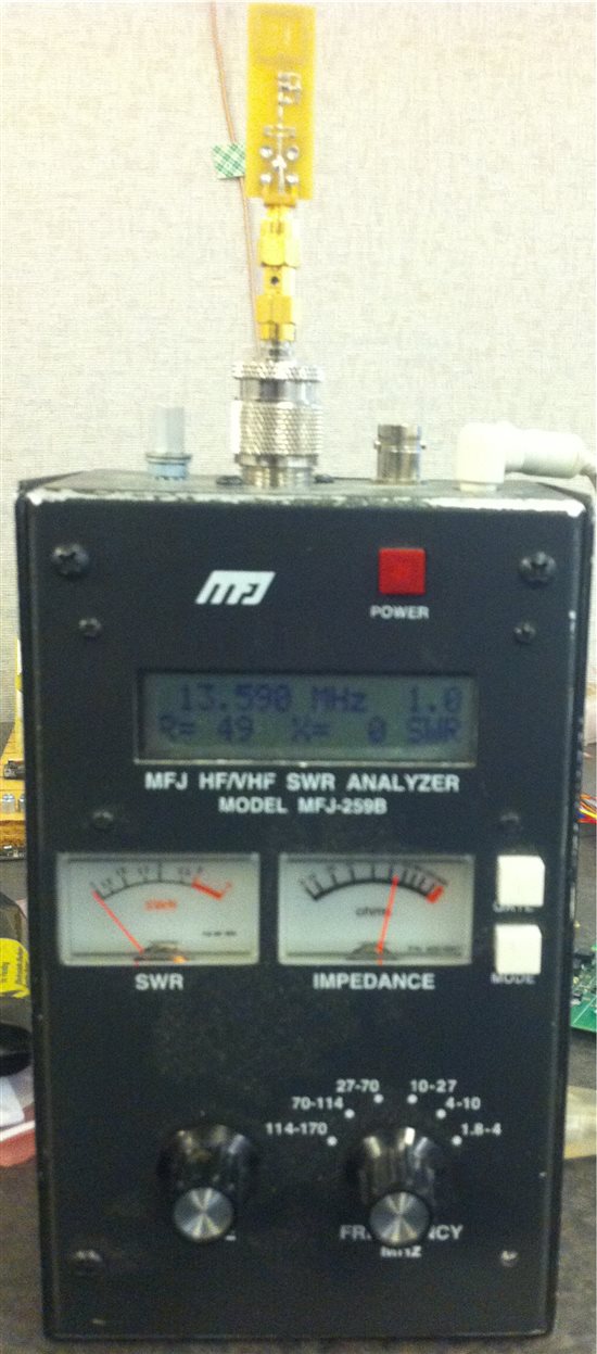

  • Brad,
    How are you measuring this with the MFJ259b?
    First, make sure that your antenna is completely disconnected from the reader circuit.  Connect your antenna with a short coax cable or SMA to SMA connector.  See picture below for a good example.  At this point, you should have the tuning values populated.  Go to the Impedence R & X mode of the MFJ.  Use the tune knob to adjust to ~13.56MHz.  You should now see your impedence and SWR.  In the image below, R = 49 and SWR =1.0.  This antenna is tuned very well.
    If you can also provide a picture of your setup and measurements, that would be helpful.
    Eddie LaCost

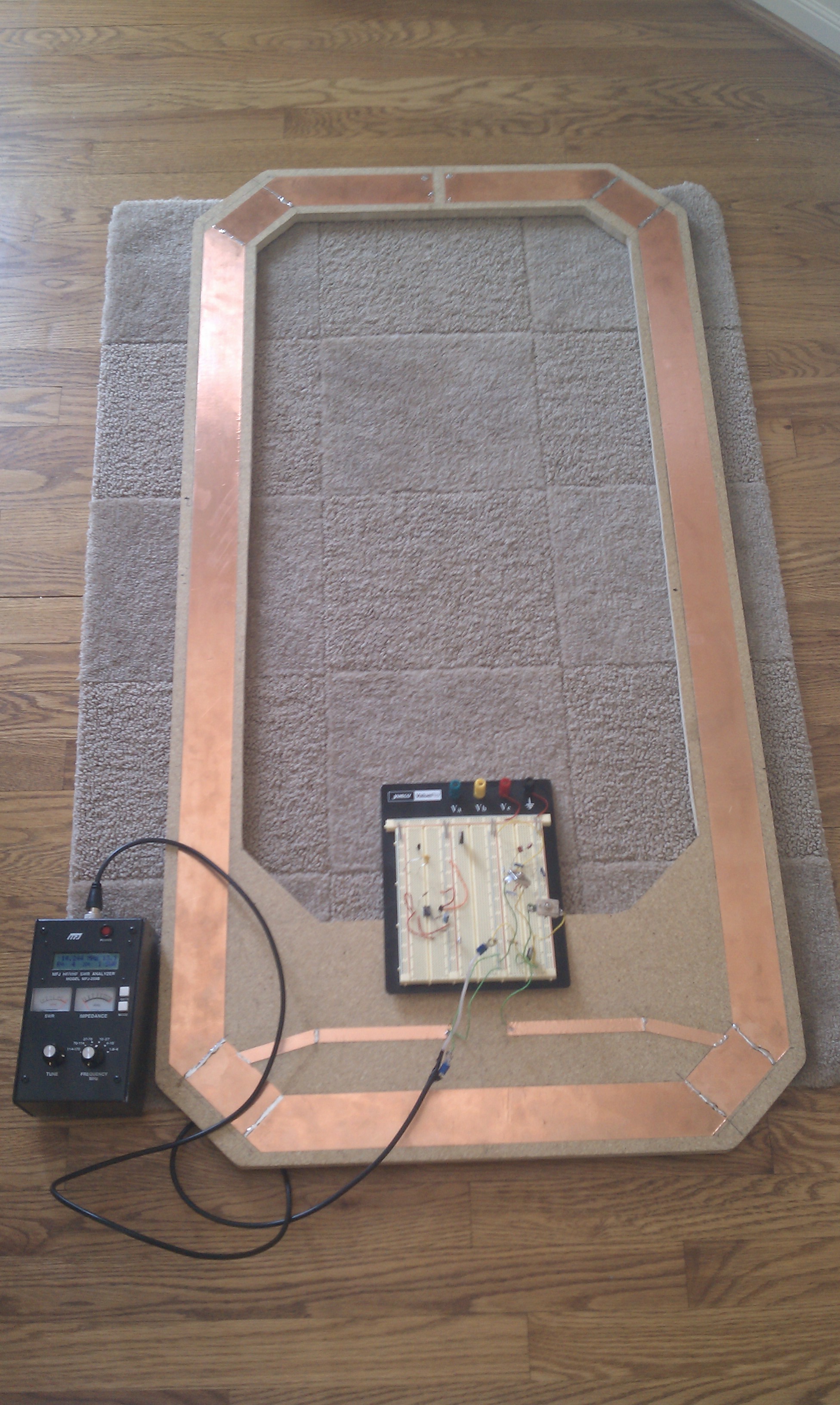

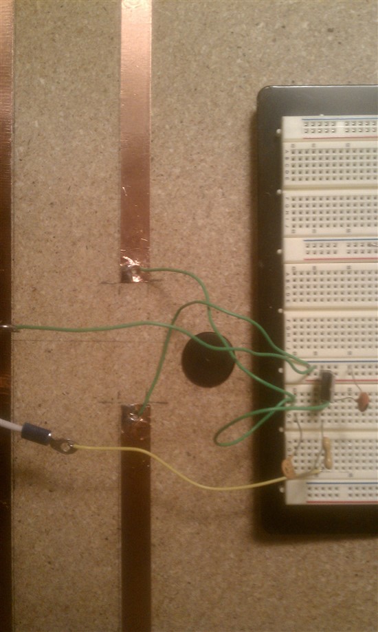

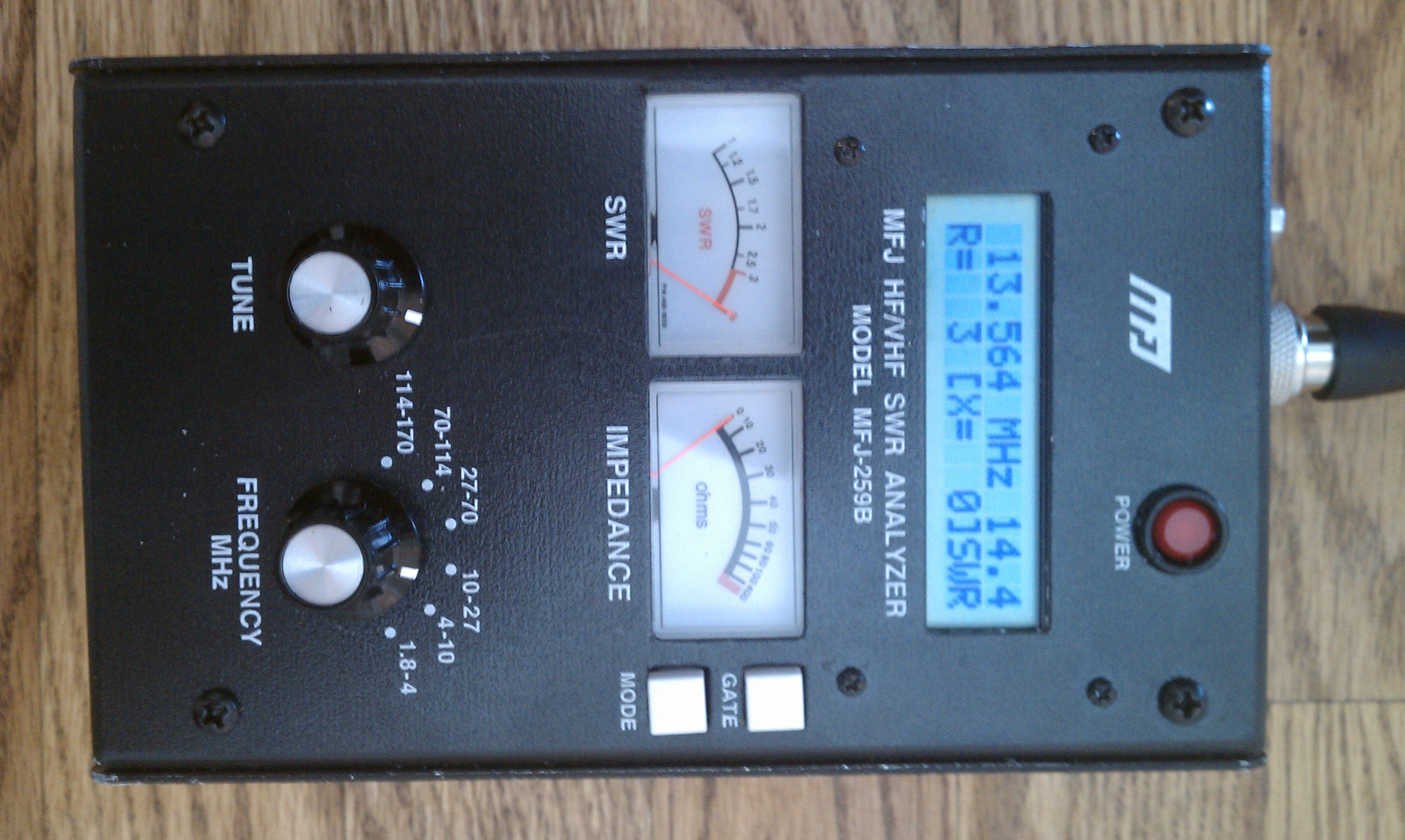

  • I am using the Tune to Resonance Mode (x=0) under the advanced mode. The following picture are my setup. I am using a somewhat long coax cable but it is the same length that I will be using in the design when finished. As you can see using the calculated cap and resistor values The complex is correct but real impedance is only 4-5ohms. (The other circuits on the breadboard are for different applications.)
  • Thanks for the pictures.  How large is this antenna?  It looks like 1000 x 600 from our app note.  I think this is probably too large for the TRF7960 to drive properly without a power amplifier.  What range are you trying to acheive?  What tag size?  This antenna design is intended for a high power reader.
    To do an unbalanced capacitive match, you should have a loop with matching components parallel and series to the loop.  For your antenna, you could remove the T matching arms and tap the coil on the other end.  Again, this antenna is probably too large for the TRF7960EVM to drive properly.  TRF7960 is just 200mW output power.  You probably need about 1W for the antenna pictured.
    Eddie LaCost

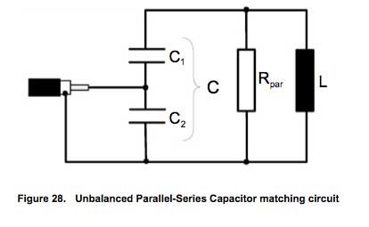

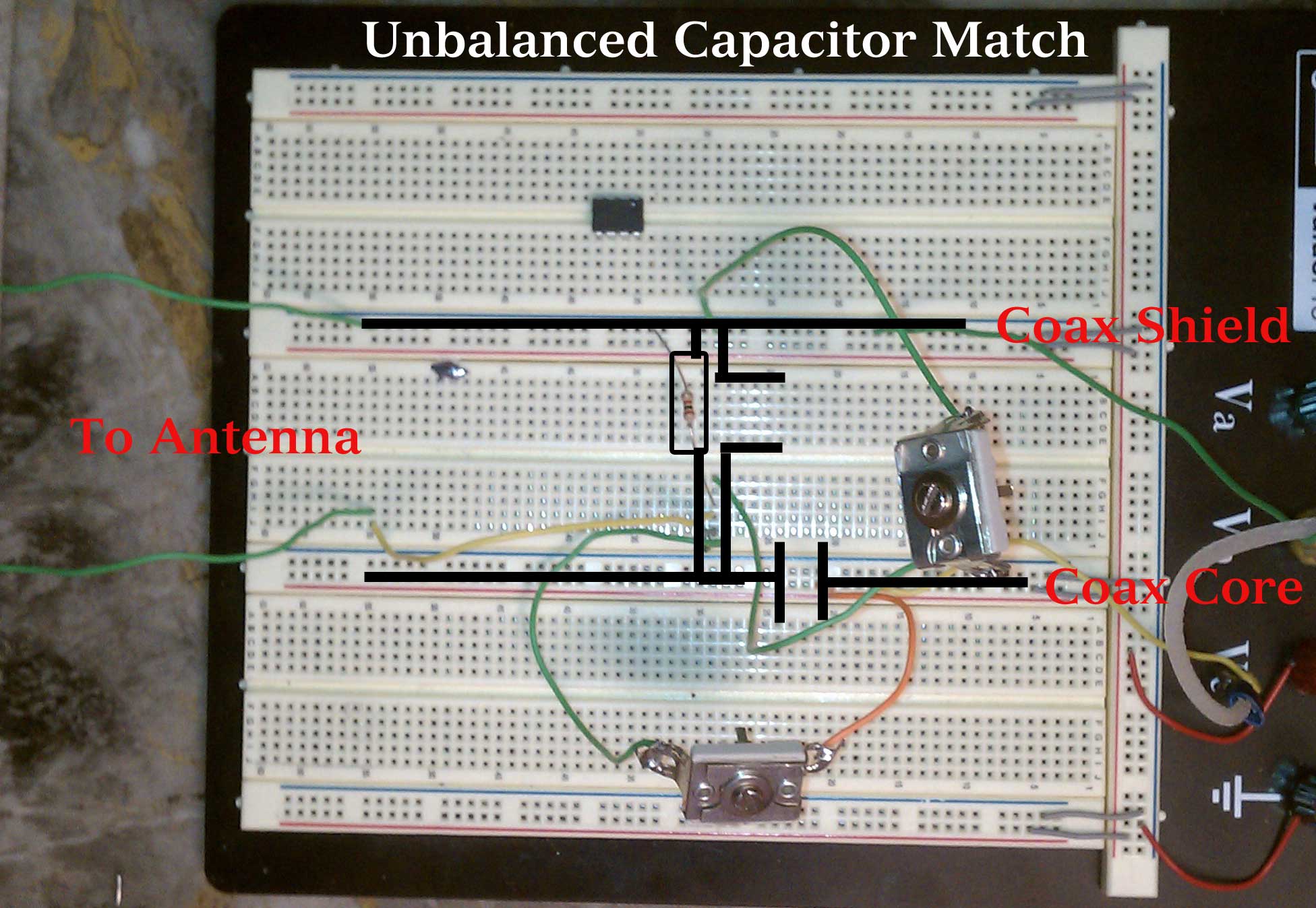

    Can you try doing an unbalanced capacitive match as shown in the attached mock up of your photo?  You should measure the antenna complex impedence again to ensure you are getting a similar value before placing components.
    You may need to remove the T arms as well to get an accurate measurement.
    Eddie LaCost

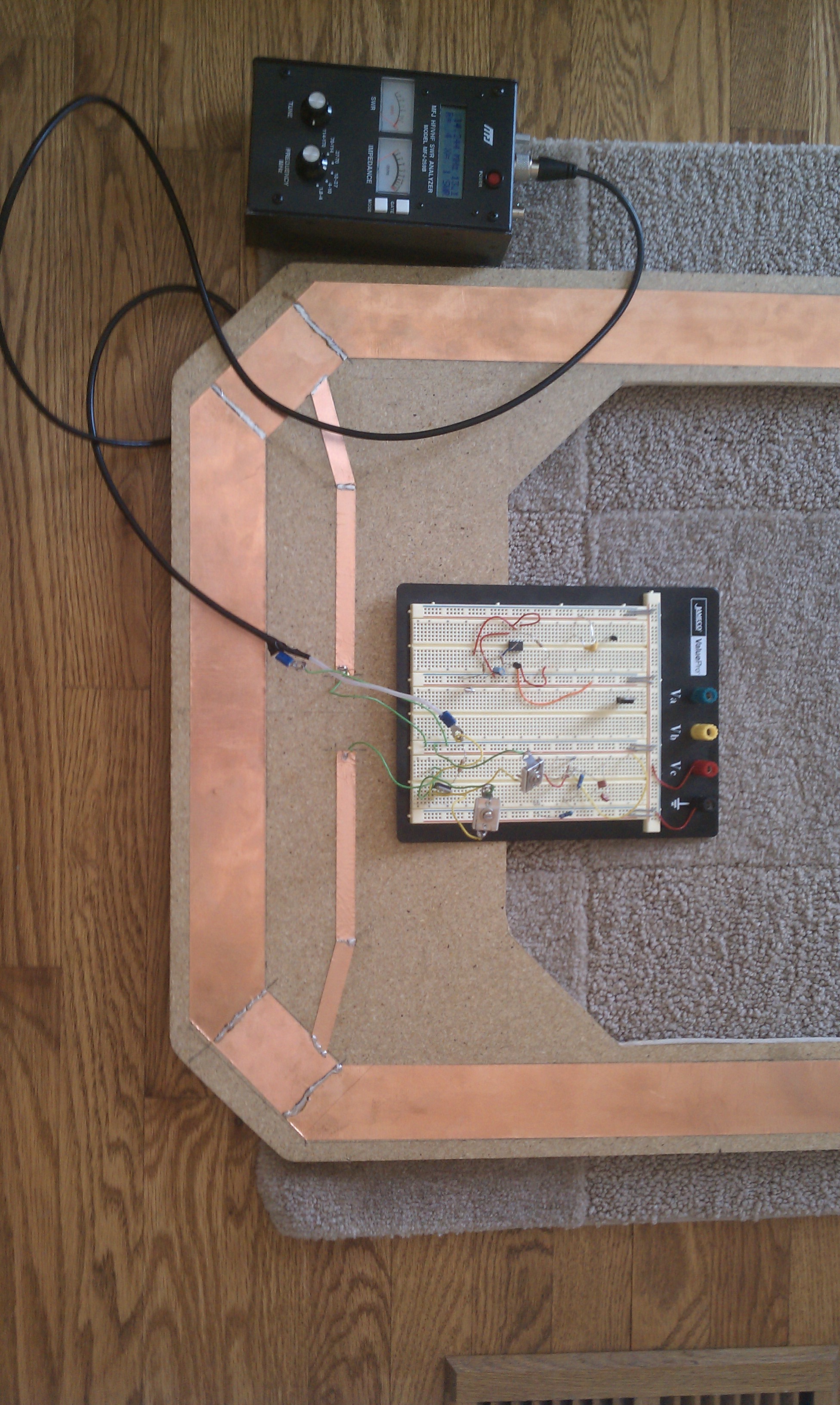

  • The following picture IS NOT photoshopped.
    The end resulting circuit was the following the the Tag-It Antenna Design Guide. The know all of the steps have helped along the way but there was one thing I noticed that I was doing wrong that was stupid enough not to say. What you did say is true though; I hooked it up to the reader and launched the windows app and it won't read a tag. Although it does not give any bogus information that it thinks it finds anymore so I would assume it is working. I know I tried to look for one before I bought the 7960 but do you guys make a higher wattage reader or a power amp for the 7960?
    I am using RF-HDT-DVBB - 13.56mHz Overmolded Transponder. The project that I am using this in needs the 2' X 4' read area but only about 6" of read range. The bottom will he shielded and will only read the top side.
    Thanks again, Brad.
  • That looks good.
