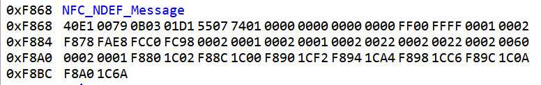

For my application, I would like to write some configuration parameters (just a few bytes, really) to the RF430FRL152H using an external transceiver. I have configured a MSP-EXP430G2ET + DLP-7970ABP to write to some portion of the FRAM memory, for example writing a few bytes starting at NDEF block 0x0A. (I don't care about having a properly formatted NDEF message, as this device will only be used with a custom transceiver. I just want to stick the configuration parameters somewhere the firmware can have access & where they can be read/verified via ISO15693 commands)
My NFC_NDEF_Message section of FRAM initially looks like

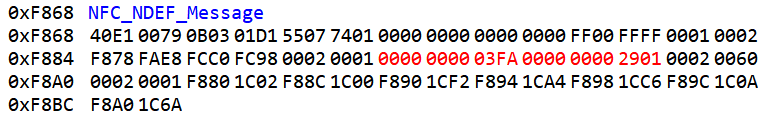

and then after I've written to 3 blocks (using ISO15693_sendWriteSingleBlock) starting at block 0x0A I see the memory contents update:
This all works well, except that when the MCU restarts (e.g. after a soft reset or power cycle) the application fails to run (CCS debugger shows program counter at random locations, device doesn't respond to further ISO15693 commands). I suspect that I'm interfering with some aspect of the ROM or perhaps tripping CRC verification? If so, could you advise on why this is happening and if there is a "safer" approach or memory location I should be using?

    I am working off the NFC_Only sample application. One thing that might be relevant is that I changed the size of the FRAM_NDEF and FRAM_CODE sections in the linker file:
        // code area, can be increased /  decreased
        // FRAM_NDEF + FRAM_CODE lengths must equall 0x768 (with FRAM_NDEF starting at 0xF868)
        // Two sections together in the range of 0xF868-0xFFCF
        FRAM_NDEF               : origin = 0xF868, length = 0x0018 // ends at 0xF8CF - NDEF memory section
        FRAM_CODE               : origin = 0xF880, length = 0x0750 // ends at 0xFFCF - Firmware memory section

    Looking at the memory map and where the bytes are changing, you have exceeded your FRAM_NDEF space and are into the FRAM_CODE space, so that's whats causing the restart issue.
    Can you share the ISO15693 API's you have written in SLOC297 to write the data? I should be able to see where the mapping is wrong by looking at that.
  • Hi Ralph,
    Obvious now that you point it out! I adjusted the block number I am writing to and that seems to have fixed it.
    On the SLOC297 side I have modified the NFC_appIso15693 function a bit as shown below. (Note, I defined START_BLOCK as 0x0A. But I adjusted to use 0x02 and this seems to fix the problem.)
