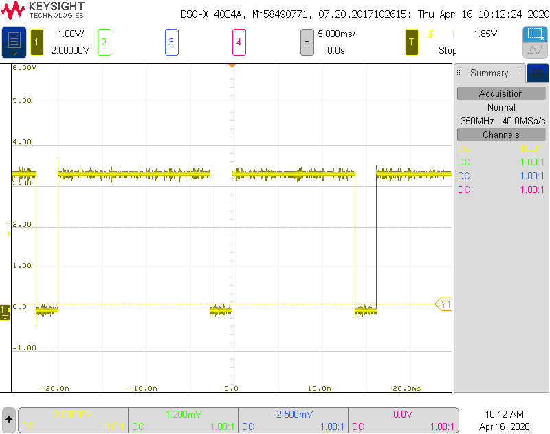

  • Hi Ralph,
    so i notice that i cannot reach the data rate of 424kbps.
    Below you see our code in main and we are sending data without the GUI on the PC and measuring a GPIO to see how fast can he send the data and how many packages can be send out.
    • If we send 1 Byte than it takes around 14ms to resend the next byte.
    • If we send 125 Bytes it takes around 16.3ms to resend the next 125 bytes
    • If i send more than 125 bytes the NFC state changes and doesnt stay at NFC_DATA_EXCHANGE_PROTOCOL
    I made the test on one direction and on both directions and they worked only at maximum 125 bytes.

    Here is the screen shot measuring GPIO_PIN_3 and you can see the time that it takes to resend the next bytes (both directions are sending 125 bytes)
    424kbps is over the air. That is not total transfer time. There is overhead to send data. Highest data rate we measured between two TRF7970A's IIRC was ~35kByte/s but I don't remember if that was passive P2P @ 424kbps or R/W & Card Emulation @ 848kbps. I think for P2P, 30kBytes/s is doable.
    That is expected. If you send more than 125 bytes - it has to send through multiple cycles.
    The TRF7970A has a FIFO that is 127 bytes in size. Two more bytes are needed for packet overhead. So the packet gets divided when more than 125 bytes are being sent. This is exactly how the device must operate.

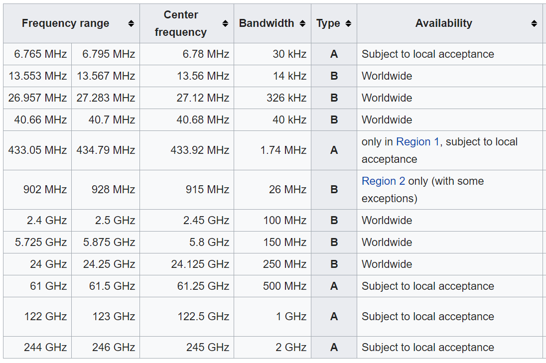

  • Hi Ralph,
    thank you very much for your answer.
    Since i cannot reduce the 15ms time to resend data, i dont think the TRF7970A is suitable for my application than.
    I can do the protocoll on the MCU myself and i dont need to be compatible with other devices on the market. Do you know any transceiver i can use from TI?
    My goal is to use a frequency that is worldwide allowed. The lower the frequency the better is it to integrate to the application i think.
    Maybe CC1201 looks like it can go up to 1250kbps and works with many different frequencies?
    How low can the freuqency go? Does it work also with 13.567 / 27.283 / 40.66 MHz?
