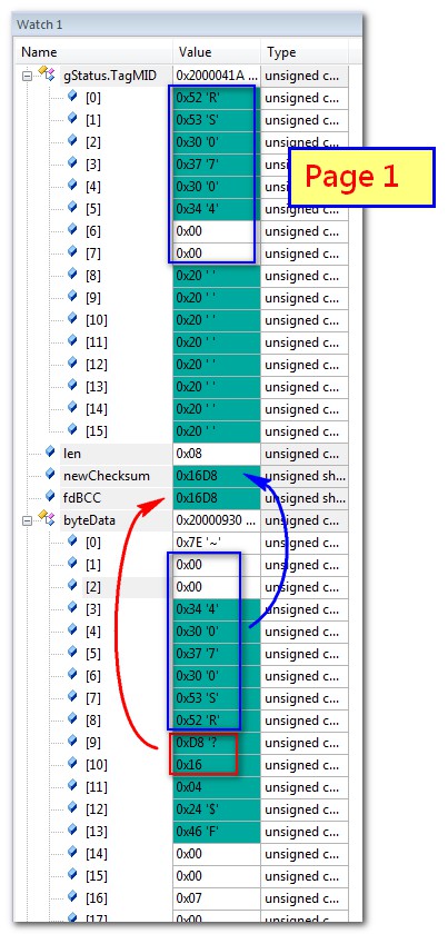

At the 12cm distance, the reading result is good.
We can get the correct data – [52 53 30 37 30 34 00 00, 8 bytes from Page1] and the BCC is correct.
Note: we use the BCC to check the transit success or not, between RFID transponder and the RFID reader.

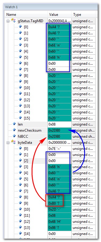

At the 13cm distance, the reading result is not good.
We can get the correct data – [A4 A6 60 6E 60 68 00 00, 8 bytes from Page1] and the BCC is correct.

    I tried to understand the problem but was not able to understand the pictures. You wrote in the subject the data is wrong but the BCC is not.
    Both pictures are described as data and BCC correct. In the second picture only 7 bytes of data are marked. Is this correct?
    Please explain the problem with an example of the not correct data you receive.
    Is the 13cm, where you noticed the problem, the far end of the reading distance?

  • Hi Helfried,
    Thank you for your info, we used the same transponder (DR2B-40) and RFID reader to do this test.
    We put "RS0704" into the DR2B-40, we just moved the tag position from 12cm to 13cm and then we found the reading content is wrong but the BCC is correct. We used the other two DR2B-40 tags to do and got the same issue from reading results, too.
    We suspect there is something wrong in the Tag IC of DR2B-40, so the RFID tag transited the wrong info to the RFID reader.
    Another, we had used the old version DR2B-30 (wrote with the same data) and used the same RFID reader to test the reading status, we found the DR2B-30 never have the wrong data and the correct BCC. The DR2B-30 is very stable to transmit data to the RFID reader during one hundred cycle reading tests at the 13cm reading distance.

  • Hello Herbert,
    the RD2B-40 and the DR2B-30 both have the same silicon chip. The differences between these transponders are production related and the DR2B-40 has a slightly longer antenna.
    When looking at the screenshots you provided, I see that in the bad case the protocol is shifted by one bit (one bit is missing at the begin). To come closer to the problem we have to see if really the transponder is responding not the correct data, or if the reader is not able to detected it correct.
    If you have the possibility to check the transponder response with a pickup coil and scope and check if the response is different when moving from 12cm to 13cm this would be helpful.
