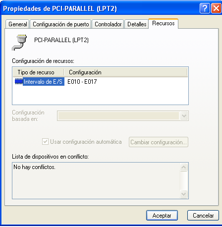

  • Hi ! Excuse me, i have the same problem as Mark, but with the software "CC1010 Flash program utility".
    I only can select "LPT1" in the port options of this software, but i have a LPT PCI card in the memory position "E010-E017" (its named LPT3 by Windows XP)
    Please, can you modify this software in the same way you did with Mark and his problem? Or can you give me another solution?

  • Hi Dario,
    I have been looking at the code for this flash programming utility and this case is not as easy as the previous. The "LPT1" option is something that is provided by the "tvicport" driver. A check is done with the base port address 0x378 to find the number of parallel ports. in your case it obviously only return the "LPT1". Could you have a look at the device manager for some more details about the LPT3 port? Like the example below.
    Is the memory position "E010-E017" taken from here?
    There is also another address that is used in the code: "physical low address" and I don't know what it means. So even if I replace the 0x378 with 0xE010, I don't know if this is all that is required. I have changed the code and rebuilt the application, but I would be surprised if it is working.
    Øyvind

  • HI Øyvind,
    First of all, i appreciate your help.
    Unfornunately, the application still does not work.
    Yes, i take the address "E010-E017" from here:
    Windows named this port as "LPT2", but in the app (original version and your modified version) only appears "LPT1" in the options.
    (Yes, my pc has a LPT1 port "onboard" too, but this has not the "bracket connector" installed in the motherboard... so, its recognized by windows as 0x378 and LPT1, but i cant use it. For that, i bought a Pci card LPT)
    I think the simplest solution for my problem will be, find a connector for my LPT1 onboard, or another computer :)
