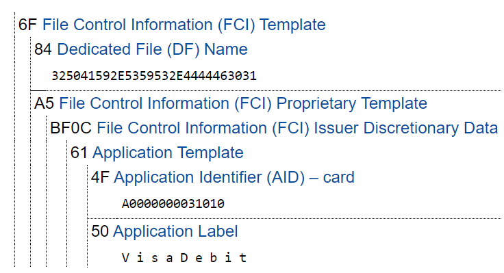

I am driving DLP7970 over SPI with tm4c123. I am trying to read the card number and expiration date. T0 type smart cards are generally not a problem, but on T1 cards, they usually only read as mifare. What is the reason for this error? Why can I only read mifare information on some cards?
    can you please give me more details about what cards are you using. I am not aware of the T0 T1 types you are referring to.
    Helfried
  • Hi Helfried,
    Thank you for response.
    I am working on T4t type smart cards. I can read mastercard type cards. In visa cards, the t4t I have sent below falls into error status.
    With this structure, I can read the card number and expiration date information from mastercards. But in visa cards, it falls to the error I marked below with bold font.

    As for the error, I suspect the card rejected the command that was sent - that would be the most common cause for that error. Cards will reply back when they receive an invalid command and the NFC stack will then report back a fail to the lower levels. So you will need to review the command sequence used.
    If I remember right, Mastercard and Visa had different sequences, but that was only something I looked into a bit like four years ago, haven't touched any of that in a long time to really offer more feedback unfortunately. Hope that is sufficient to get you moving forward though.
  • Hi Ralph,
    Is this problem caused by the Device#B01 error?
    The dedicated file was sent before the AID number was sent in the image above. In the code I shared, a direct AID number is sent. Does this pose a problem?
    Have you ever applied your credit card with trf7970?I examined all the application notes, but I did not come across such an example.
    Is it certain that we will have problems in communication with credit cards due to error Device#B01? Or can this problem be overcome?
    Do you have any idea about this problem? or can you share an example?
    thank you.
    The errata only causes an issue for certification. And if it impacted a card at all, then you wouldn't be able to communicate at all with it.
    I don't know, we have no experience and do not support payment applications.

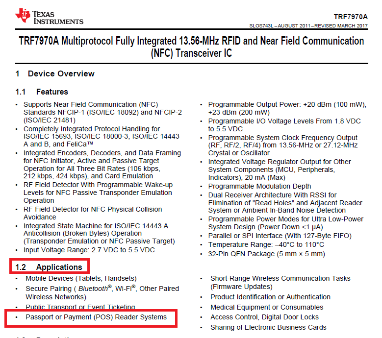

    In datasheet also includes payment systems in the field of payment application. if there is this error, it cannot be used in payment systems. why didn't you remove it from the application area?
  • Hello Onur,
    I'll raise that with our product manager. I presume the answer will be either that the section wasn't updated post-errata uncovering or that it could be used in a proprietary payment application where EMVco is not required. Though if the latter then it should be clarified as 'non-EMVco' systems.

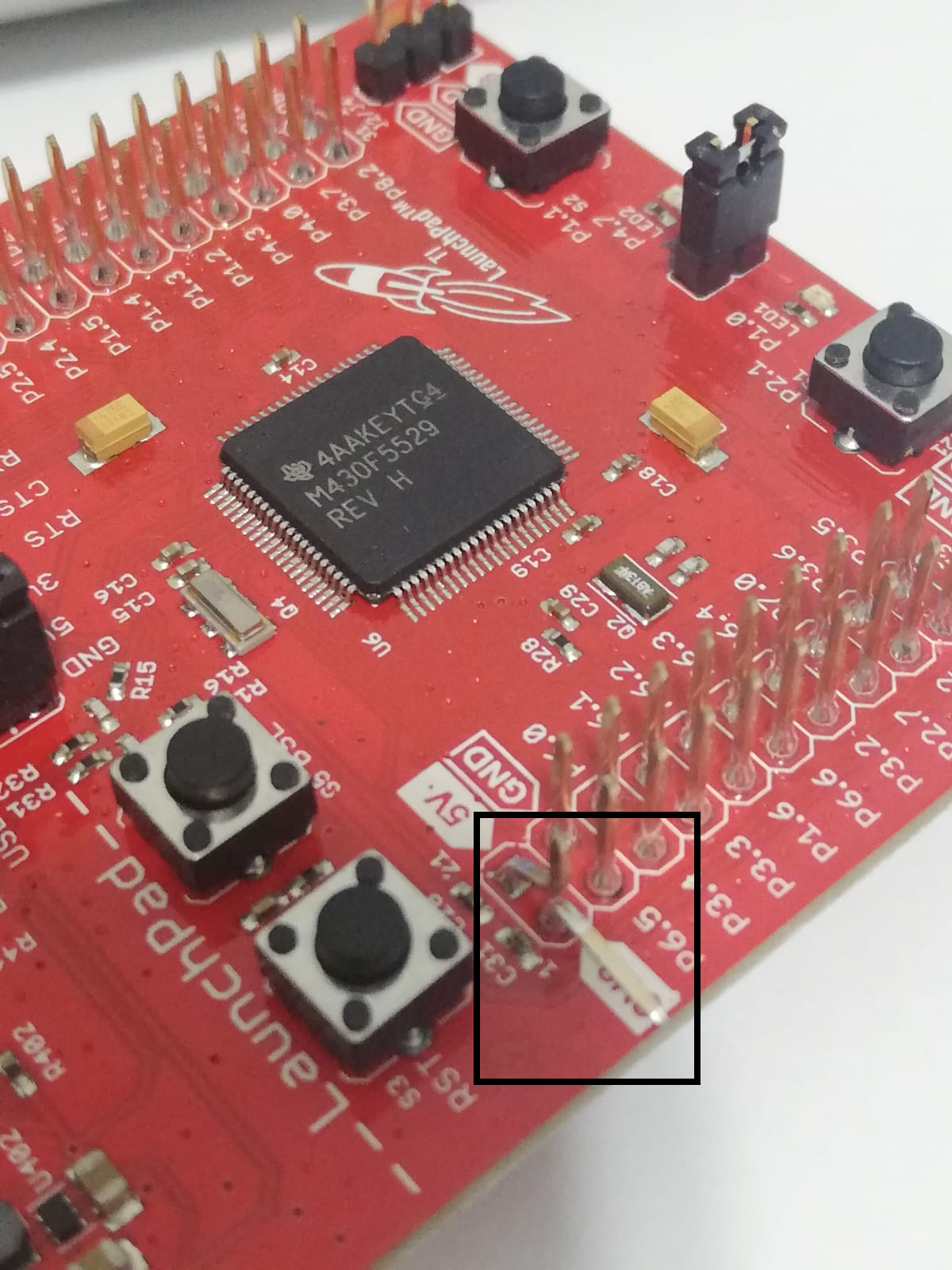

    I connected the power input of DLP7970 to 5 volts.
    I also configured it on NFC as follows.
    Is there any other adjustment I can make?
    thank you.
  • Hello Onur,
    You have to supply 5V to the VIN pin of the DLP-7970ABP too.
    You'll need to bend the 3.3V pin for the LaunchPad so you don't fry it, and then route a wire from the 5V pin to the DLP-7970ABP VIN (pin on the BoosterPack headers).
  • Hi Ralph,
    I made the 5v connection as below.
    Do I need to do anything besides this?
  • Just verify the power is stable, hopefully it is. Usually I do a blue wire. But if it is stable then that should be it.
  • In this way, the power LED of the card is on. Apart from this configuration mentioned above, there is nothing else to do to increase the antenna detection distance, right?
