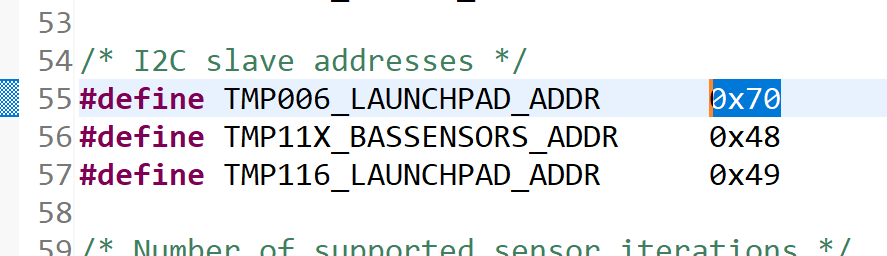

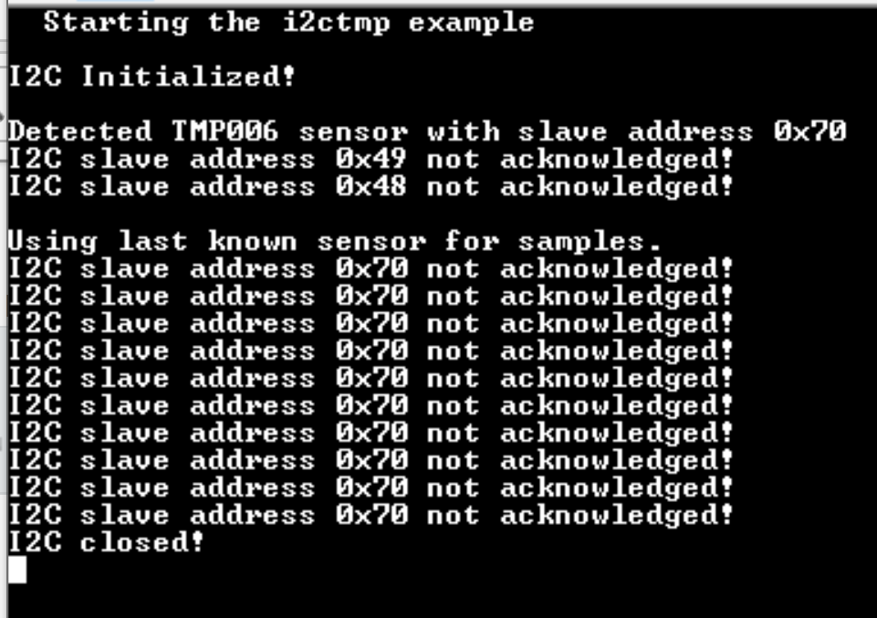

Here are some photos I tried using I2ctmp.C file. Modifying the address of the first temp sensor.
However I keep receiving no acknowledgement. Also I cut short the sample from 20 to 10 just for easier testing.
I guess I miss out some part or maybe the example codings is not meant for this sensor.

    Could you share datasheet of the sensor and what modifications you did to the code?
    As your example seems to detect the sensor when probing for it (the "Detected ..." printout) I would assume the sensor is running as it should. In that case, I would guess that the "Not acknowledged" prints is due to you sending a command to the sensor that is not valid (which means it does not ACK you back). You do not need to consider the ACK/NACK yourself, this is happening under the hood and the driver will report back if the sensor responds with a ACK or NACK. The actual way ACK and NACK is used for a specific device could vary but typically a slave ACK all valid data, a NACK is the same as not responding (which could be because there is no sensor or the request was invalid).

    Currently, I only change the sensor address from the original 0x01 to 0x70
    This is the only changes I made to the codings.
