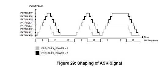

    when I want to take out a wave pattern such as the figure "FREND0.PA_POWER = 7 " in OOK/ASK
    Should I set the TX POWER VALUE in PATABLE[0]~[7]  for good ramping     PA[0] < PA[1] < PA[2] < PA[3] < PA[4] < PA[5] < PA[6] < PA[7] ?
    Thank you for your help.
    kenji
  • The answer to the question is "yes". That is, PA[0] < PA[1] < PA[2] < PA[3] < PA[4] < PA[5] < PA[6] < PA[7].
    The easiest way to get the PATABLE setting is to use SmartRF Studio and tick off "PA ramping". You will then get a PATABLE consisting of 8 entries.

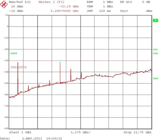

  • Is this description valid for FSK/GFSK modulation?
    I have a problem with the 6th harm. -> it is to big, so I am searching for a solution. From the test lab I got the answer that we "switch to strong".
    Could I solve this using PA Table ie set 2 or 3 power grades, to "switch bits gently"
    Thank you.
    PS
    On the picture, is the proposed power limit, ie we shoud stay out of tv band...
    We could solve the problem by setting the lower send power, but we need 10dBm..
  • What is the level of the 6th harmonic and exact frequency ?
    What is your operating frequency and output power level ?
    Regards,   Richard.
  • Thanks for a fast answer.
    We use 868.9 MHz. Harmonic power is visible on the posted picture..

    What are the possibilities to reduce the power of the 6 harm, only by changing software( cc1101 parameters)?
    Ervin
    Is the harmonic spur at 5.2123 GHz or 5.2134 GHz ?
    Regards, Richard.
  • Hi.
    It is 5.2134GHz
    With some hardware changes we pushed 6th under -30dBm (marker 1), and that is (almost) ok, but we are still not satisfied...
    So back to my question, does this PA table ramping system works with FSK/GFSK?
  • The harmonics level is not dependent on whether PA ramping is enabled or not. Please note that when doing compliance testing under En 300 220 you will measure the radiated spurious level. The antenna has a finite BW and will lower the 6th harmonic to well below -30 dBm.
  • Agree also that with a 868 MHz antenna; the radiated level will be significantly lower and PA ramping will not help here.
    With standard multi-layer inductors from Murata the level of the 6th harmonic is usually around -56 dBm conducted with 12dBm output power at 868 MHz so your level seems quite high. If wire wound inductors are used the level can be surpressed furthermore but multi-layer inductors should be sufficient.
    Check out DN032 (http://www.ti.com/litv/pdf/swra346) concerning the choice of inductors used in the RF structure.
