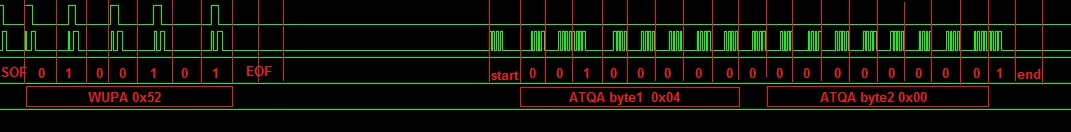

  • Hi, im here again,
    i'm trying to use the directMode 0 to communicate with a Mifare card, im sending the commands encoded with the Modified Miller encoding and now Im trying to decode the Modified Manchester raw stream.
    Manually decoding works perfectly, i know how Modified Manchester encoding works and I'm trying to use a Microchip PIC18 to decode that signal.
    Anyone could give me some hints about how to decode that signal?
    with some tags the raw stream starts low, with others it starts high like in the nextt picture Shouldnt it start always low?
    the pic is showing the first bits of the answer to the WUPA 0x52 command :   0x04 0x00
    any suggestion?
  • The TRF7960 does require the use of Direct Mode 0 for the authentication of Mifare cards. Mifare is not fully compliant to ISO14443A (this is well known) but it does use the ISO14443A air interface in the beginning, so you don't need to go into Direct Mode 0 quite yet as you can use the part in Direct Mode 2 (default) for this part of the sequence.
    But if you really want to do it this way, then get a copy of ISO14443-2 and -3 standard.
    -2 will explain to you how to decode this and -3 is for the commands.

  • Thanks for the answer.
    I've already done the first sequence (anticollision and set tag active) using direct mode 2. Now I was trying to use directMode 0. After sending the commands with a Modified Miller encoded signal, i get the reply but i'm having some problems with the synchronization of the subcarrier.
    May I use the directMode 1 for reading a Mifare tag? It would help me decoding the manchester subcarrier signal.
    Im going step by step, im not yet into the crypto stuff, so I still dont have everything clearly in my mind :)

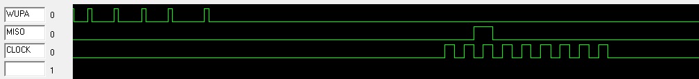

    So my question is: whats the differences between DM0 and DM1? In what case would be useful to use DM1?
    Robby Morrill said:
    ...but i actually haven't been able to see what a direct mode 1 bitstream looks like.
    Here i have 2 logs of the command WUPA 0x52 made with my logic analyzer.
    The first is DirectMode 0:
    The second is the DirectMode 1, after the WUPA command i get 9 clock pulse (pin 22) 8bit data LSBFirst (0x04) and the parity bit (0)

  • @ Axxe (i think)
    You can use Direct Mode 1 (or 0 or 2) for what you are showing here with ReqA/WupA, the Anticollision loop (all the way to getting the SAK) - the problem is when you go to authenticate the device...this is when you must drop into DM0. The why is a parity bit that can't be handled any other way than directly in this case with the TRF7960.
    I am working on the comms section of the latest rev of the DS...i am putting in section (with LSA plots) to help explain this better - so look for that soon or just keep posting. i do have screen shots and some other docs i made on this topic as well.
    JDW
