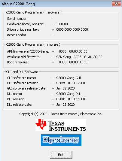

  • Hi,Gregory Czajkowski
    Add some information:
    1、The version of our C2000-Gang is as below. "Serial number" , "API firmware"  and "Boot firmware" cannot display normally. Please help us to correct them.

  • You should check drivers and connection. When label is not displayed correctly, the C2000-GANG will not work.
    Gregory Czajkowski

    Software is correct. I was talking about USB driver. Please check if the programmer is detected under Device Manager.
    Gregory Czajkowski

  • Let‘s review our application scheme and communication records.
    There are two TMS320F28335 chips on target board. We want to download the program to chips by C2000 Gang. We can control the connection status between 14pin and TMS chips by electric relay. So we can download one chip and then the other, that means we execute the download process in serial mode not parallel mode. C2000 Gang is connected to PC by RS232 not USB. The download process is as below.
    Now we have two problems:
    1、  When we use GUI software to download certain program to target from channel 2, the result is  PASS. But when we use DLL to download the same program to the same target from channel 2 with the interface C2000GANG_SetConfig, the result is FAIL, and we get the error return from DLL, the error code is “MCU device init.” .  We are confused that there are different results from GUI software and DLL when using channel 2. The same problem is not happened when using channel 1. Maybe DLL revision is not applicable or exists some bugs. Please help us to analyze this problem and solve it. Or can you send us the latest DLL?
    2、The label of C2000 Gang is not displayed correctly, but it can work. How to make the label correct?

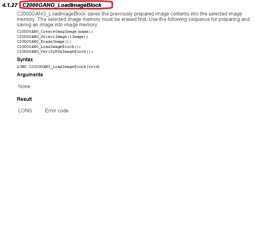

  • Hi Gregory Czajkowski,
    Now we have an application requirement of C2000-gang: we want to load the .C2000gangimage file generated by the local PC into the specified image channel in the memory of C2000-Gang by calling C2000-GANG.dll. But no related functions was found from《C2000 Gang Programmer (C2000-GANG) User's Guide》.
    We tried to use C2000GANG_LoadImageBlock() . But there was no input parameter like image file name and path of this function.
    So please give us some suggestion.
    Wangcaixia
    Wangcaixia

  • Hi Wangcaixia
    You should use the C2000GANG_ImageFileLoad function. See below syntax in the C2000-Gang.h  header
    //The C2000GANG_ImageFileSave and C2000GANG_ImageFileLoad Save/Load the image to/from file
    // Used internally by GUI
    LONG WINAPI C2000GANG_ImageFileSave( LPTSTR filename, LPTSTR name, LONG type, LPTSTR passw );
    #define BINARY_EXTENTION ".c2000gangbin"
    #define IMAGE_FILE_EXT ".c2000gangimage"
    // note -> extention in the filename will be removed and added extention as above to the final file name.
    // for example file name filename.aabb will create files
    // filename.c2000gangbin
    // and filename.c2000gangimage
    #define PROJ_SEC_UNPROTECTED 1
    #define PROJ_SEC_PASSW_PROTECTED 2
    #define PROJ_SEC_PC_HW_PROTECTED 3
    #define PROJ_LOCK_EN 0x10
    // available type in the C2000GANG_ImageFileSave
    // type = PROJ_SEC_UNPROTECTED or PROJ_SEC_PASSW_PROTECTED or PROJ_SEC_PC_HW_PROTECTED
    // or (PROJ_SEC_UNPROTECTED | PROJ_LOCK_EN) or (PROJ_SEC_PASSW_PROTECTED | PROJ_LOCK_EN) or (PROJ_SEC_PC_HW_PROTECTED | PROJ_LOCK_EN)
    LONG WINAPI C2000GANG_ImageFileLoad( LPTSTR filename, LPTSTR passw, LONG mode );
    // mode -> 0. Other value reserved for the future.
    Let me know if that helps.
    gregory Czajkowski

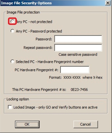

  • Hi Gregory Czajkowski ,
    We tried C2000GANG_ImageFileLoad function to load a new imagefile to C2000-Gang and then executed the download process, but only the old imagefile was downloaded.
    Do you mean that this function cannot be used effectively without GUI?

  • Hi Gregory,
    Have you received my email on October 19th? Maybe there was some problems between our two company email. My company email is  caixia.wang@hirain.com , and my personal email is monitorxia@163.com .
    We saved the imagefile not protected like the below options. So we called the function C2000GANG_ImageFileLoad( LPTSTR filename, LPTSTR passw, LONG mode ) with the input parameters: null to "passw" and 0 to "mode".
    Wangcaixia
  • Hi Wangcaixia,
    If you do not have the password then set the image number first where the image must be saved. Then
    err = C2000GANG_ImageFileLoad( file_name, “”, 0 );
    if( err == ERR_NONE )
      err = C2000GANG_LoadImageBlock();
       err = C2000GANG_VerifyPSAImageBlock();
    Gregory Czajkowski

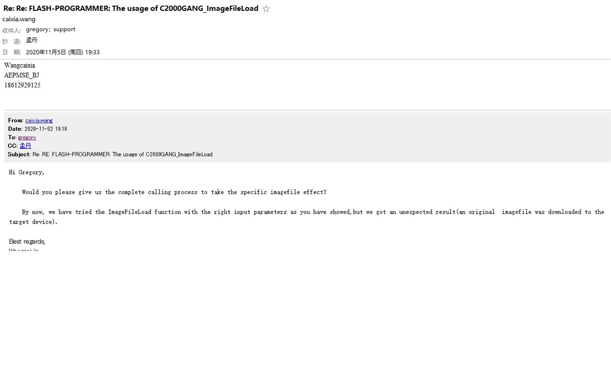

  • Hi Gregory,
    Would you please give us the complete calling process to take the specific imagefile effect?
    By now, we have tried the ImageFileLoad function with the right input parameters as you have showed,but we got an unexpected result(an original  imagefile was downloaded to the target device).
    Wangcaixia

  • Hi Vamsi,
    When could I receive your reply for the last request?
    Wangcaixia
  • Wangcaixia,
    Elprotronic will reply on this tomorrow.
    Thanks and regards,
    Vamsi
  • Wangcaixia,
    Please contact Gregory (@Elptrotronic) directly at gregory@elprotronic.com.
    Thanks and regards,
    Vamsi
  • Hi Vamsi,
    I sent the email to Gregory on November the second.
  • Wangcaixia,
    Gregory is working on a demo for you.  He hopes to send the details to you today.
    Thanks and regards,
    Vamsi
