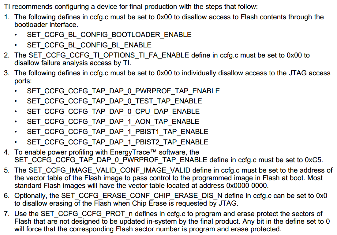

I am Juan and I am working with the CC1352R1 MCU. My aim is to protect the flash memory, but also to know how to unprotect the flash memory of the device once protected.

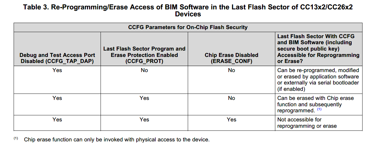

I am attaching some screenshots of the main parts of the TI docs I have already read about this topic.
The table is taken from the doc called Secure Boot in SimpleLink™ CC13x2/CC26x2 Wireless MCUs and the text below the table is taken from the doc called CC13x2, CC26x2 SimpleLink™ Wireless MCU Technical Reference Manual.
I have also searched in the SDK version 4.20.01.04 but did not find any function for protecting/unprotecting the flash memory. I deepened into the files NVSCC26XX.c and NVS.c and found some functions like NVS_LockFxn and NVS_UnlockFxn, but I read that they are used for other purposes, not for the one I want.
So, in conclusion, I guess the protection method which I should carry out is the one described in the text below the table. Is there anything more I should take into account? How is the unprotection method?

  • In addition to reading about the Customer Configuration (CCFG) section in the TRM, you can also look at the flash documentation in driverlib:

  • Hi Juan,
    If you have protected the flash that means that you cannot read or write to flash. The only way of unlocking the flash is the forced mass erase which wipes the whole flash of the device and resets the CCFG to the default values. It is unfortunately not possible to unprotect the flash using the serial bootloader.
    There is an application note about the serial bootloader on the CC2538/CC26x0/CC26x2  devices that where you can find a lot of useful information if you are interested in learning more about it.
    If you want to perform a mass erase using JTAG in Flash Programmer 2, you should mark the device under "XDS-110, XDS-xxxxxxxx", press Tools-> "CC13xx/CC26xx Forced Mass Erase" and wait for the erase is successful.

    To clear a few confusions out here. The FlashProtectionSet() will disable the flash FSM for that given page, meaning it can't be erased or written. It does not prevent reading the flash. Calling this API will only apply the protection until the next device reset as this will also reset the flash FSM.
    How do I then get a lasting protection? Well in that case you will need to write the corresponding "protection" bit inside the CCFG region. This region is read during device bootup (ROM level) and in cases a flash page is set to be protected, the flash FSM will be disabled (and this would occur each reset until the CCFG protection bit was cleared).
    This means that you can select from having a "device level" protect where the specific region is set to be "protected" during boot, or you can handle it yourself (potentially leaving it unprotected during bootup).
    As for how to check what is protected, you can use the FlashProtectionGet() API.
