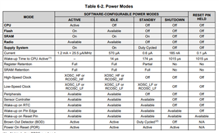

For achieving low power, the radio shall be turned off when it isn't needed. It will causes device to enter deep sleep.
Some of devices would be frozen after few days in my tests, and its VDDR dropped to 0V.
In SmartRF Flash Programmer, the devices could not be identified.
If I set the level of LPM to SLEEP, this problem will not appear.
Does anybody could tell me why cc1310 would be frozen or what situation would make VDDR become 0?
  • I'm not familiar with contiki-NG and I therefore don't know which definition of power modes it uses. From the HW perspective the power modes are defined as:
    I would assume you get issues in standby. In standby the power system is duty cycled meaning that the level of VDDR is recharged at intervals. If you measure VDDR when in standby you will see this. Also see chapter 2 in https://www.ti.com/lit/pdf/swra478. If something happens with the recharge interval the recharge will fail and the VDDR will go to 0 (or worst case, VDDS)
