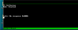

LAUNCHXL-CC1310: TI 15.4 linux stack ,issue not getting interactive command line option.
Part Number: LAUNCHXL-CC1310
Hello ,
I need a help ,regarding the CMD OAD feature of TI15.4 stack,
I am using TI15.4 Linux Stack,version 4.20.00.05
LAUNCHXL-CC1310 SDK version 5.10.00.48
and trying to deploy on Raspberry Pi Zero W.
And I have already cross-compiled the TI15.4 stack by using the below thread.
https://e2e.ti.com/support/wireless-connectivity/sub-1-ghz-group/sub-1-ghz/f/sub-1-ghz-forum/751391/linux-cc1310-how-to-install-ti-15-4-stack-gateway-linux-sdk-on-32-bit-system

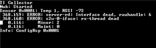

and i am getting error as shown below and also even not getting "CMD" option for OAD.
Abhay
