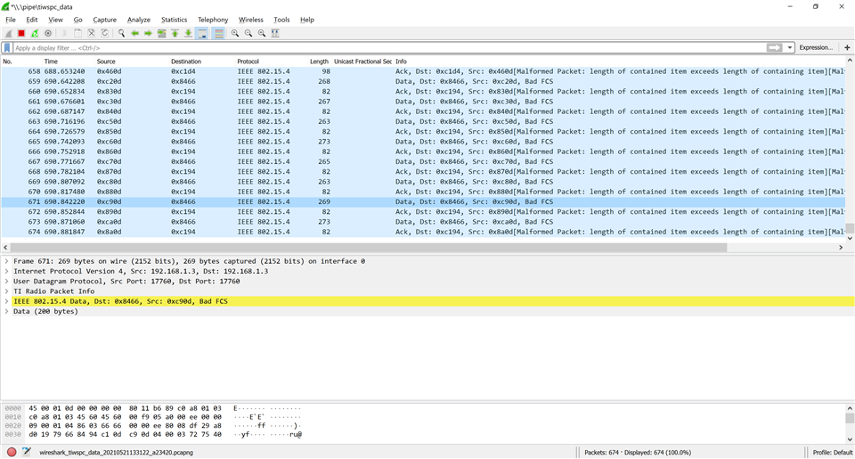

Hi, I just upgraded Smart RF Packet Sniffer 2 from version 1.8 to version 1.9.  Now in version 1.9 Wireshark is telling me my messages all have errors.  I didn't see this behavior before on version 1.8.
The application pictured running here is based off of the 15.4 Sensor/Collector example with frequency hopping on the 200kbps 915MHz PHY.
