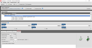

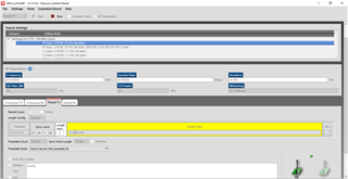

  • I am using tow Launchxl-cc1310 as RX and TX with rfWakeOnRadio example and 5o kbps and these problem still showing up
  • I am using tow Launchxl-cc1310 and both of them has 50kbps and 915 mhz settings from smartrf code
  • Have you tried to use the Launchpads to SmartRF Studio directly?
  • that is what I got in smart RF with 5m distance
  • Why have you selected based on CC13-90 on the RX side?
  • I did my test again with smart RF and if you mean this then both of my launchxl are working fine in 10-20 m range when it is selected but when LAUNCHXL-CC1310 is selected it just work in 1 m range

    , smartrf studio settings for TX
    , smartrf studio settings for RX
