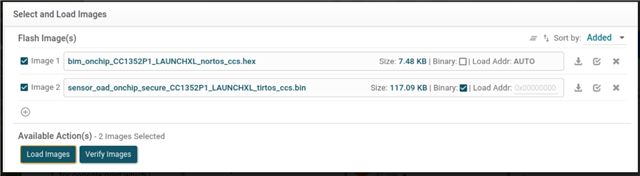

Hello!
We are currently having an issue where debug prints are not coming on the debug console when it is flashed through uniflash. Whereas the debug prints come if entered to debug mode through the GUI in CCS studio.
Key Details :

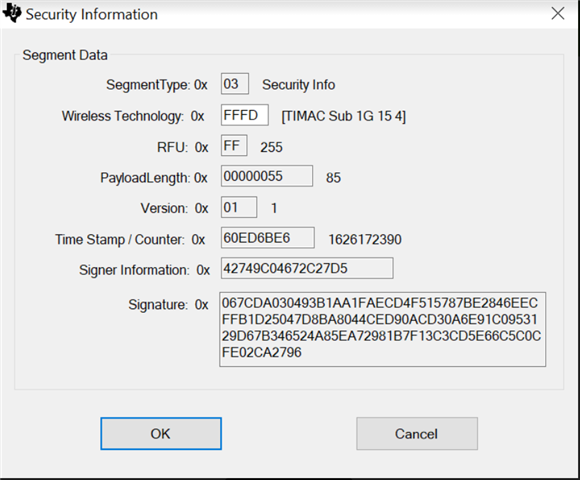

1.Private-Public key pair is generated by python keys/key_generate.py within the OAD tool folder. [ ${COM_TI_SIMPLELINK_CC13X2_26X2_SDK_INSTALL_DIR}/tools/common/oad ]
2.Customer private key provided to the tool, the OAD Image tool generates the image header file with the security information segment that includes the image signature.
3.Image signature is added as part of the image header during the OAD image tool post build step.
4.Image header is appended to the .hex and .bin file.

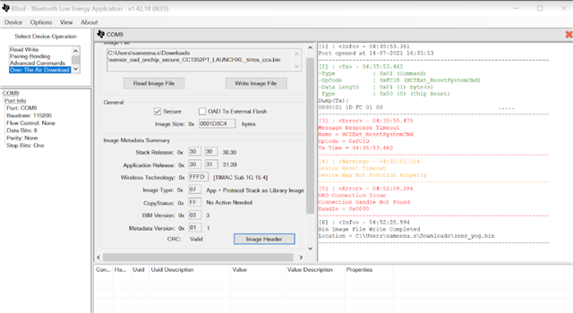

OAD tool is enabled as post build step into build configuration by adding "${COM_TI_SIMPLELINK_CC13X2_26X2_SDK_INSTALL_DIR}/tools/common/oad/oad_image_tool --verbose ccs ${PROJECT_LOC} 7 -hex1 ${ConfigName}/${ProjName}.hex -k ${COM_TI_SIMPLELINK_CC13X2_26X2_SDK_INSTALL_DIR}/tools/common/oad/private.pem -o ${ConfigName}/${ProjName}"
We have added application code to sensor_oad_onchip_secure example code. We are able to build the code with release configuration.
