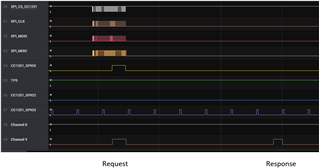

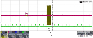

Hello everybody,
In my application, a battery-operated transponder (slave) should communicate with a wired remote station (master) via radio. The CC1201 is used as the RF chip on both sides.
In order to be able to work in an energy-saving manner, the slave should be operated in sniff mode for approx. 500 ms after each message sent in order to be able to receive the acknowledgment or a command. The master sends with a preamble of 30 bytes.
Question 1.)
How must the sniff mode be set on the slave so that every message can be received?
When changing from transmit mode to sniff mode, the synthesizer (SCAL) and the rc oscillator (WOR_CFG0.RC_MODE = 0x02) are always calibrated. The calibration of the synthesizer often fails because the marcstate "IDLE" is not established. Instead, the marcstate 0x11 (RX_FIFO_ERROR) is read out.
Question 2.)
Why doesn't the calibration run without errors?
Question 3.)
Does the master answer too early under certain circumstances?

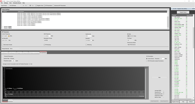

  • It sounds like you have entered an RX FIFO error that you have not handled correctly. You always need to respond to a FIFO error by flushing the FIFO (SFRX and/or SFTX).
    Also, I do not understand why you need to change the registers every time you enter Sniff mode, as you can use the same settings in TX.
    Another thing is that it should not be necessary to have any timeout on the calibration, as there is nothing that can prevent this from finishing.
    To configure sniff mode correctly you should use SmartRF Studio, select the setting you want to use and the “RX Sniff Mode” tab. Here you can configure RSSI threshold, preamble length etc.
    You code should do something like this:

    Unfortunatelly I do not receive every message. Please see following scope:
    yello: antenna signal at sender
    red: GPIO0 (PKT_SYNC_RXTX)
    blue: GPIO2 (PQT_VALID)
    green: GPIO3 (WOR_EVENT0)
    Why doesn't cc1201 not set GPIO0  (PKT_SYNC_RXTX) in marked situation? EVENT0 rises in middle of preamble (sending 30 byte).
    To doublecheck the situation, i have a picture from a logic analizer, which triggered the identical situation:
    CC1201_GPIO0 is the signal at the RF chip (identical to the scope above, red channel)
    Channel 9 is the same signal from an cc1201 evaluation board, driven by SmartRF-Studio. (bottom line)
    As you can see, the eval board signals reception of "response" with GPIO0, my application board doesn't!
    Is there any explanation?

  • As stated earlier, I recommend that you use the settings given to you by SmartRF Studio for sniff mode. There is no need for you to set this up yourselves.
    I notice that your Cs threshold is very high. are you sure that your RSSI is above -73 dBm when receiving from your transmitter?
  • Hi Siri,
    thank you for all assistence. Sniff mode is now "up and running". I have to test it and (perhabs) to do some fine adjustments, but in general it is doing! Thumbsup
    SmartRF-Studio's template "100kbps, 2-GFSK, ETSI Standard (868MHz)" suggest -90 dBm in sniff mode. The user manual says:
    The  CS  threshold  should  be  set  high enough so that CS is de-asserted when only background noise is present and low enough so that CS is asserted when a wanted signal is present.
    So, I think I have to play with this parameter.
