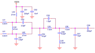

    The previous versions of the LAUNCHXL-CC1352P-4 was designed for 20 dBm at 433-510 MHz but this was changed since generally the 433 MHz is a low-power band.
    Attached schematic for 20 dBm PA port for 433-510 MHz:

  • Thanks for your info on the C1352P matching network reference for PA port, Richard.  One more question, if best load impedence for front end PA is 50ohm according to PA datasheet, does that mean based on other chips like CC1200 for 433MHz, we can also add PA module direct into the assumed 50 ohm point of the front end chain to start with in schematics.  Anything else you advice we need to take care of, like input power limit to PA? Would really appreciate your help.
    Yuanchen
    Yes, all our RF designs are terminated to 50 ohm at the SMA so this makes it easier to add additional RF stages like FEM, PAs, antennas etc.
    50 ohm termination makes the RF measurements easier as well since this is the industry standard impedance for RF equipment.
