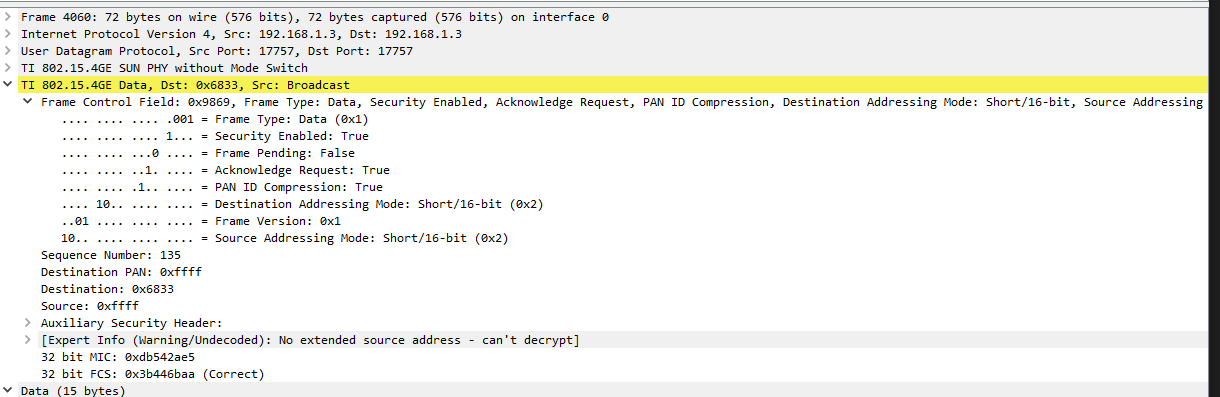

We are finding a rather difficult to debug (hard to reproduce) issue with our device nodes.
Sometimes a devices in a network simply looses their connection to the gateway. The device is still responsive (reacts to sensor inputs) but we don't get any data through our network.
Because it happens only once in a while (maybe even weeks) it is quite impossible to debug because you never know which device is going to fail in a network (mostly 20-30 devices in a network). Resetting the device is the only way out of this mode and then it works ok again.
Now what I did try today with a device that was stuck in this 'mode' was look at the network traffic with a sniffer and found out that it was still sending out data but with an 'invalid' destination PAN (0xFFFF) and invalid short address (0xFFFF). Destination itself was still correct. (see screenshot from Wireshark). Before this happened these values were correct of course (0x6833 and 0x0001).
So it looks like either the MAC layer or the sensor application loose the values for destination PAN and short address.
Our application is based on DMM sensor OAD with SDK5.10 but this was also happening in SDK4.30.
any suggestion as to why a device can 'loose' the association data?
The only two places I found in code where these values are set are: disassocCnfCb and disassocIndCb but there all the data gets reset and then destination address would also be cleared which is not the case.

  • Hi Marie,
    Yes, one direction of thinking was indeed that it get overwritten but I'm not even sure if the invalid data is within the application or that the MAC layer itself has invalid data. I mean if I was to accidentally overwrite
    devInfoBlock.devShortAddr
    I don't even think it will we updated to the MAC layer, only after rebooting the device as far as I can see.
    So I suspect that maybe the MAC layer itself might have an issue.
    Like you mention it is hard to debug especially because when I want to attach a debugger the device will get rebooted and the issue is gone then. And to let the debugger connected and 'hope' that the issue will appear on that specific device could take weeks or even months. Most devices do never show this issue.

    Thanks, I was able to connect to a running device using this solution but only for a non production device. All our production devices have a locked flash so it won't help there. Forgot to mention that earlier.
    I have found a workaround for now which also points in the direction of the error.
    I now check the current PanId and source address in the Mac layer at an interval using:
    	reqStatus = ApiMac_mlmeGetReqUint16(ApiMac_attribute_panId, &currentPANId);
    and:
    	reqStatus = ApiMac_mlmeGetReqUint16(ApiMac_attribute_shortAddress, &currentShortAddr);
    When either one of these is 0xFFFF I log that and reboot the device.
    From the log I already saw the issue happening on one device over the weekend. So this at least points in the direction of the MAC layer because that's what I'm checking and it is not being changed anywhere in the application besides the association process.

  • Hi Marjin,
    Is it possible to see from the sniffer log whether the ack failures and sync losses happen before or after the device short address and PAN ID changes? As you say, it could be the device is trying to go into orphan mode but somehow not 100% successful.
    Cheers,
    Marie H.
